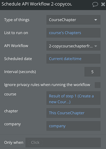

Yes, this is straight-forward in Bubble. You are going to want to look at “Backend Workflows” and “Schedule API Workflow on a List”. We do this with something that looks like this:

We do exactly what you described and we do it for a number of data types, not just chapters / courses. We store “master” records and those records are used to create templates for new companies that are created in the app.
It works using multiple steps which reference previous steps. Here is a larger idea of the concept.
Try it out and you’ll see it works.
Steps in workflow:
  1. Create a new company
  2. Schedule API on a list (All “master” records)
  3. Inside of scheduled workflow (the one you scheduled on step #2)
    3a. Create new “master” record
    3b. Schedule API on a list (All “detail” records that match the reference data type on the “master” record)
  4. Inside of the workflow you scheduled on step #4b - Create a new “detail” record
The process you describe works well, thank you!
