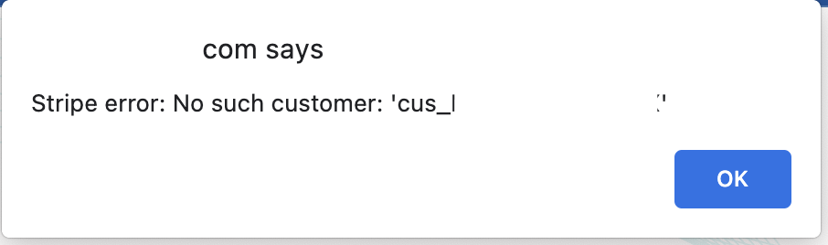

How to create Stripe customer (Getting error [Stripe error: No such customer])
Using the Bubble.io developed Stripe plugin, the action Charge the current user gives me this error:
Stripe error: No such customer 'cus_XXXXXXX'
Of course there’s no such customer, I’ve never created any customers! But then how do I create a customer? I don’t see any action in the Bubble plugin to create a customer. I tried Charge the current user but that actually generates the exact same error message.

The most likely explanation is that you’ve previously created a Customer in Stripe for that particular user, maybe without even realising it (which stored the Stripe Customer ID into a built-in field on the User datatype in your app), and then subsequently deleted that customer from your Stripe account…
So Bubble is sending the stored Customer ID to Stripe, but it doesn’t exist there hence the error message…
Unfortunately there’s no way to change or delete the built-in Customer ID in your Bubble app, so the only thing you can do is delete the User and create a new one…
If that’s not the case, then you’ll need to reach out to Bubble support to find out what’s going on…

Yes that’s exactly correct… they are built-in fields (you can’t see them or edit them) they are part of the Bubble Stripe Plugin… the data is stored on the User datatype, and is accessible in the expression builder, just like any other User field (but they don’t show up in the database, or in your app data, so you can’t manually edit or delete them).

Again, that’s exactly correct… once a User in your Bubble app has a Stripe customer ID (assigned by Stripe during the first interaction, and stored in the ‘hidden’ User field on your User datatype which is part of the Bubble Stripe Plugin, and can’t be edited), any further calls to Stripe via the plugin will use that Customer ID, and there’s no way to change or clear that.
So, if the customer no longer exists in Stripe, you’ll get the error message ‘No Such Customer cus_*********’
As I said, you might be able to see for yourself what’s going on in your Stripe account by simply searching for that customer (using their customer ID). The customer details should still show up, even if it’s been deleted (as will any log activity)… unless that is you’ve hit the ‘Clear All Test Data’ button (which may be the reason the customer has been deleted in the first place)… in which case I doubt there will be any record of the customer left in your Stripe account at all…
