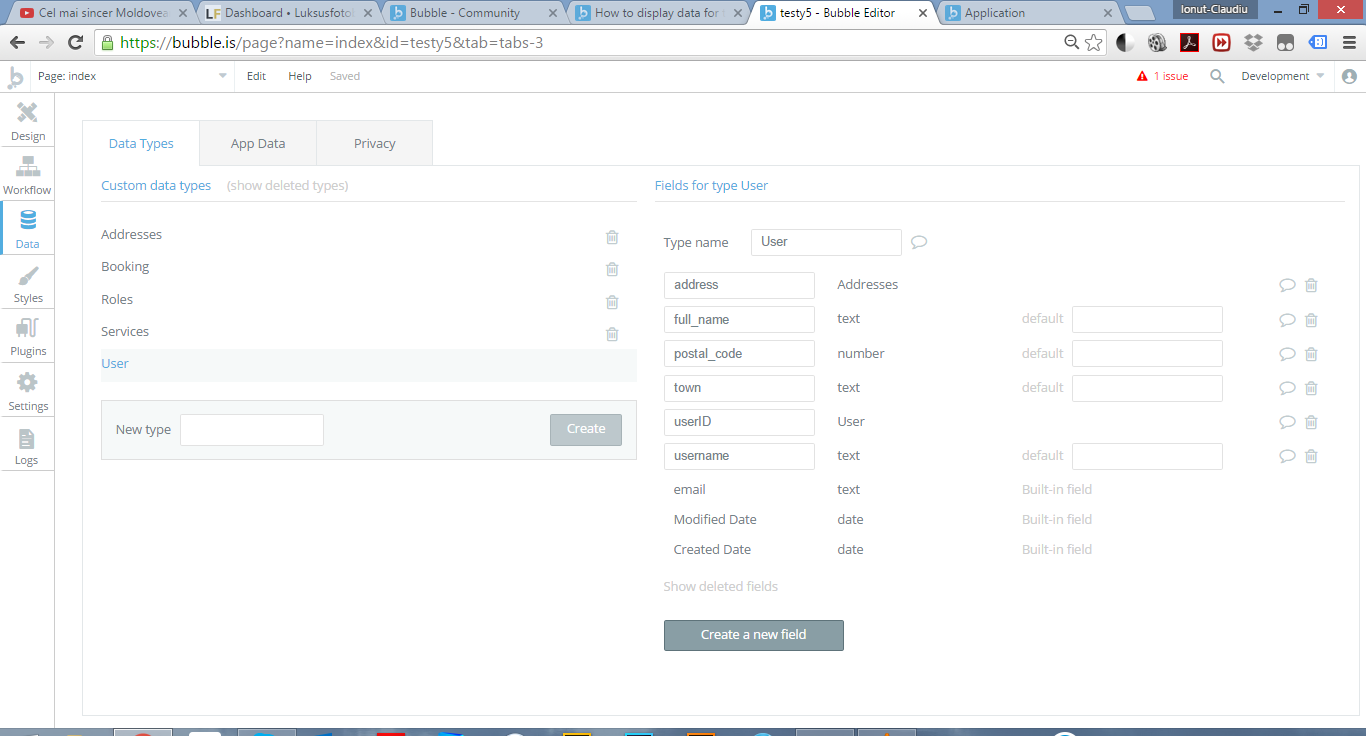

I have a data type= user , data type = address
in address i have fields like, address, street nr, town, and so on.

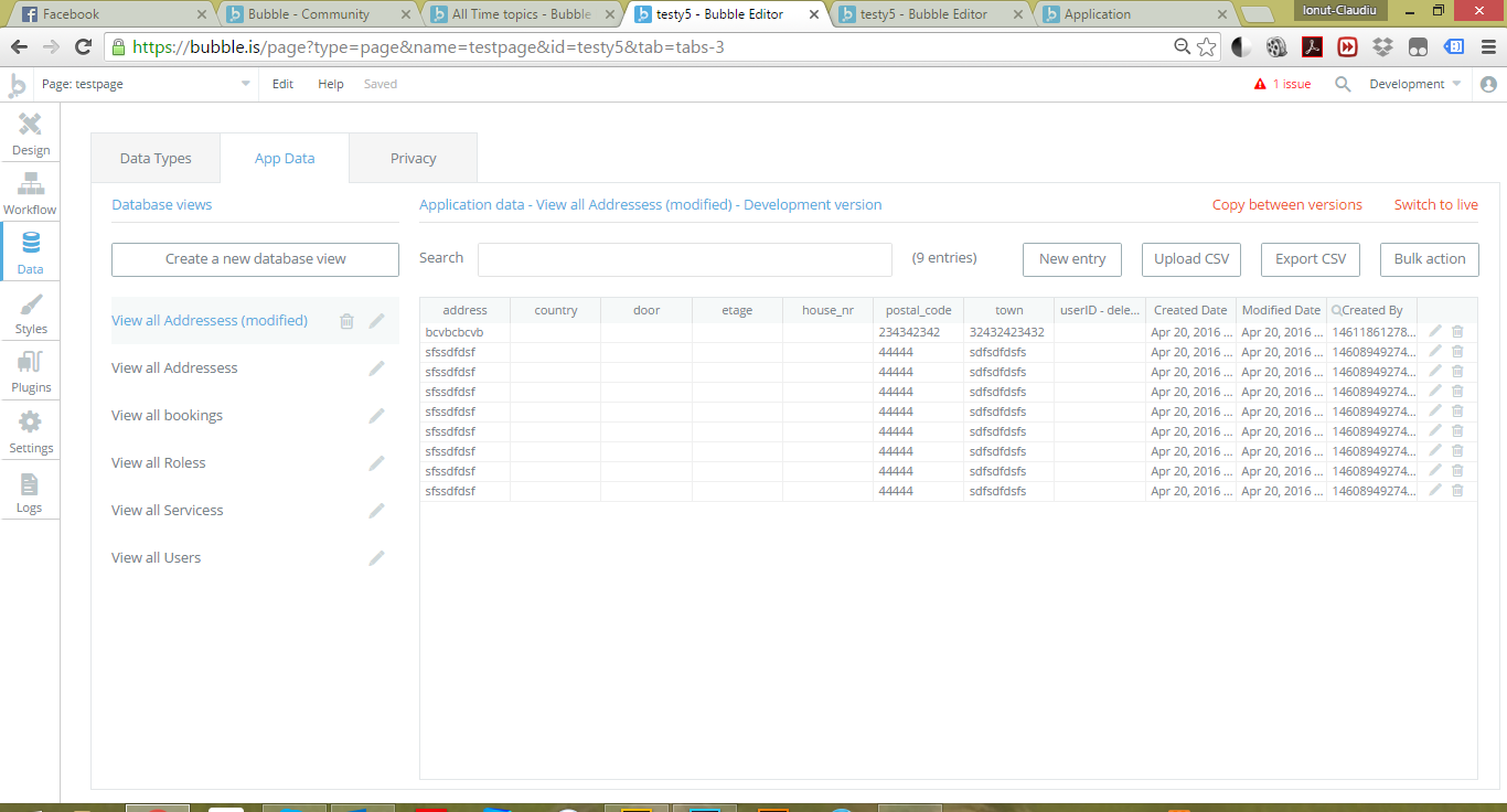

In design view i made a form where current user can add his address. when i click “Save” i can see the data in the database, i can also see that, this specific row belongs to the user:

Do you have a field on your user for “address?” The type of thing should be set to Addresses (based on your naming here). You would then save the address to the user’s address field.
yes i do.
and i get the entry in the database. But i can’t extract this information in users account in front end.
Under the “User” data-type, the “address” field needs to be a list.
