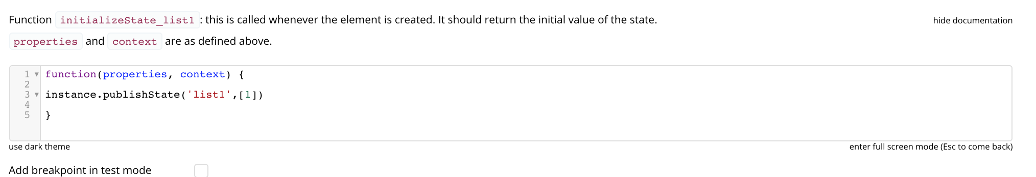

set state/work with states within the plugin
expose the state so i can get the data from it
even when giving an intial value here
