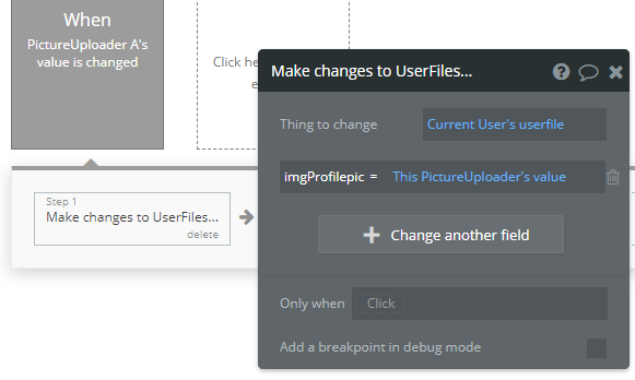

Yes, easily. Add a workflow on input change.
Store the picture uploader’s value to your database within the workflow, then clear the input like this:
It will no longer show the picture once uploaded. I usually put the uploader in a group and have the background picture of the group be the picture that was uploaded. I style the uploader to be “invisible” (no bg, no borders, no placeholder etc…) but to still be visible.
The ux feels natural because when the user clicks on their “picture” they’re actually clicking on the uploader and can instantly upload a picture. Hope this helps.
