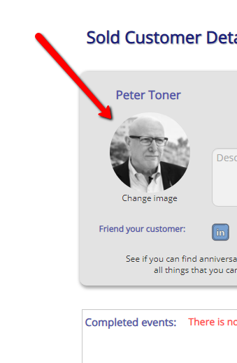

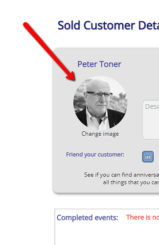

My users will upload a profile photo. I have set the photo with 360 “border” and to rescale. However, in testing, depending on the photo the user selects, the photo sometimes expands beyond the 360 degree boundary making an oblong photo. How do I force photos to confirm to a 360 degree circular shape?

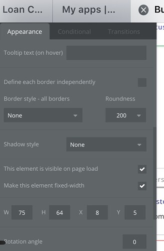

The answer is to set roundness to 200

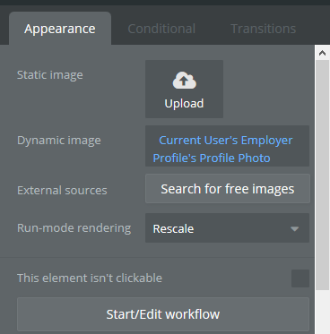

I am not seeing this option. This is what I see
13-17-13-41
I tried this, but the photo is still oblong.

The roundness option is available in Visual elements / Image for displaying the image. Not available in the image uploader.

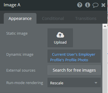

I’m still trying to figure out where you got that picture element. The one that came pre-loaded with Bubble looks like this, with the default name ‘Image A’. Because the one that comes pre-loaded with Bubble doesn’t give the extra options you showed. When I click more, these are the options I get:

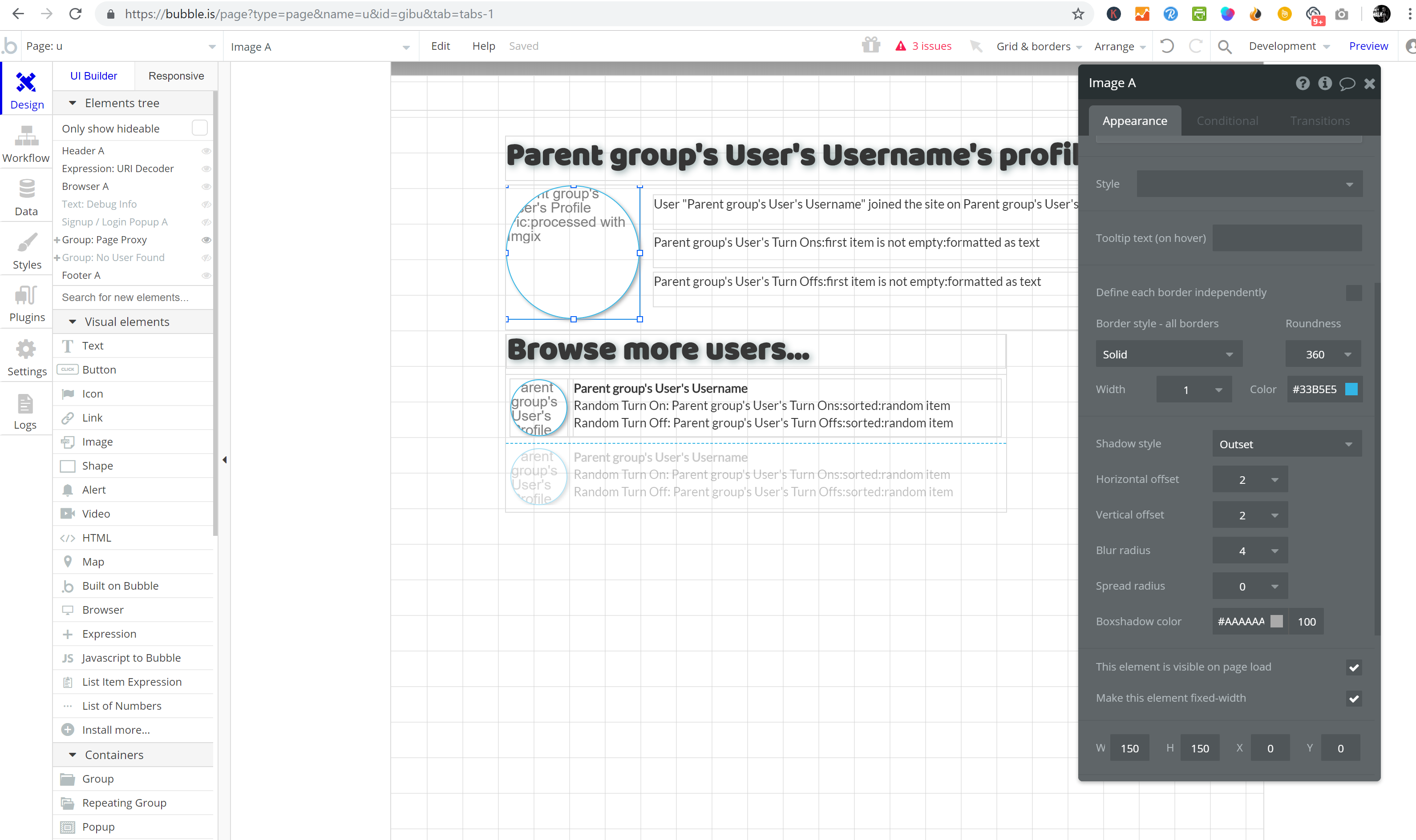

Here are my settings and output for rounded images. Hope this helps …

Here’s an example (using “fixed width” for #3) in my gibu app:
… further down the image options:
