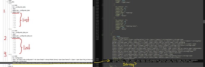

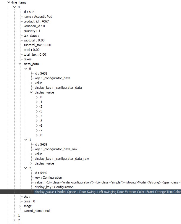

So I’m looking to get the bottom-most display_value from this JSON file, highlighted below:

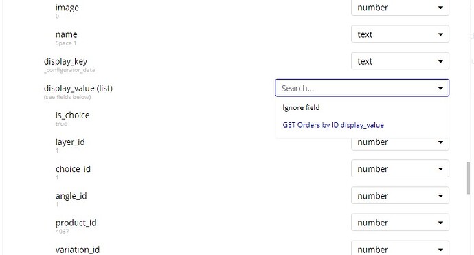

Unfortunately, the API Connector automatically identifies display_value as a list:

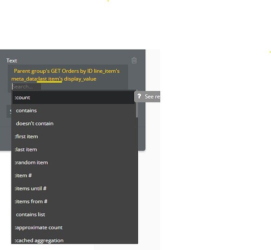

This makes it impossible to retrieve this value in my bubble app, because it throws an error unless I provide it with other fields (which don’t exist):

If you’re trying to get the last display-value then just add ‘last item’ to your expression.

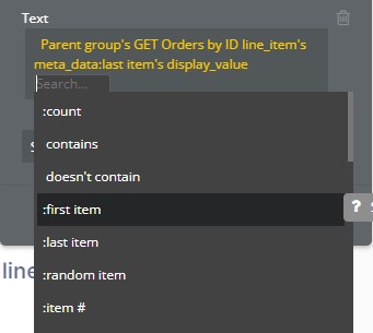

Thanks, but unfortunately Bubble is treating the display_value as a list. I can access it using last item but it still prompts me for further qualifiers.
No, I meant add last item to the end of your current expression.
Oh I see, that prompts me for more options, but unfortunately none of those exist because the value I’m looking to retrieve is a string, not a list, as you can see in the JSON response on the right:
The issue is I’m looking to retrieve display_value itself, but the API connector is identifying it as a list of values.

The display_value I’m trying to retrieve (the last one) is actually a string. There are 2 previous entries with display_values that are lists, which is why the Bubble API identifies it as such, but the 3rd one is a string (unless I’m mistaken).
When you initialized the API call, is there was both possibilities? the list and the string?
No, that’s sort of where the problem begins. In the API Setup it only has ‘list’ or ‘ignore’ as options, I can’t return display_value as a value itself.
No my questions is When you click call api (and initialized, is the response contain both possibllities? (not what Bubble show you, but what the API response return, click show raw data)
Oh I see, yes, both possibilities show up in the raw data.
display_value as a string:
