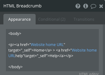

  1. I needed to use an HTML element and some code
Screen Shot 2020-09-04 at 3.25.50 PM
This code will allow you to open the link in the same tab
There are drawbacks of the HTML element since you can not set the height to a low height without having a scrollbar added for some reason, so you are kind of stuck with a higher height…I’m not sure if there could be some styling added to the HTML element to fix that issue.
  1. To go further with the breadcrumb, need conditionals on the HTML element…I based mine off of the URL parameter in the URL
So with this I have been able to create a dynamic breadcrumb navigation…now I just need to style the HTML paragraph so the text fits my app style.
