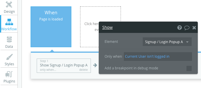

  1. Setup a signup workflow in app A (main app)
    App A main workflow

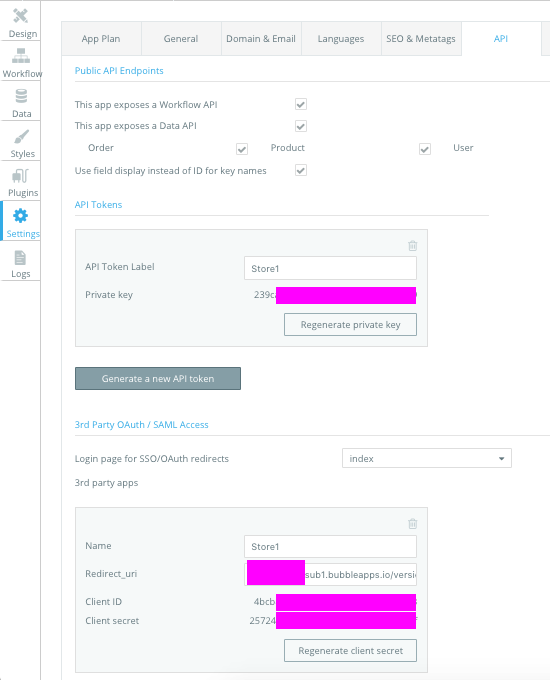

  2. In App A settings > API tab
  • Enable ‘This app exposes a Data API’ and ‘Workflow API’
  • Create a new API token and notice the Private Key
  • Set login page as the one containing your signup popup
  • Add a new 3rd party app with name (such as app B’s name) and Redirect URI which should be the landing page back in App B
  • Notice Client ID and Secret - you will need this later

  2. Add a new Bubble app within the plugin with following details:
  • App domain: appAdomain.bubbleapps.io (use custom domain if applicable)
  • Enable match versions
  • Private key - get from step 2
  • Client ID & Secret - get from step 2
