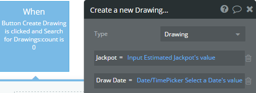

This is how I am creating new drawings:
It is interesting that this would yield the following result in the data table:
So whenever a Drawing is created, the drawing is always that 12:00am time.
