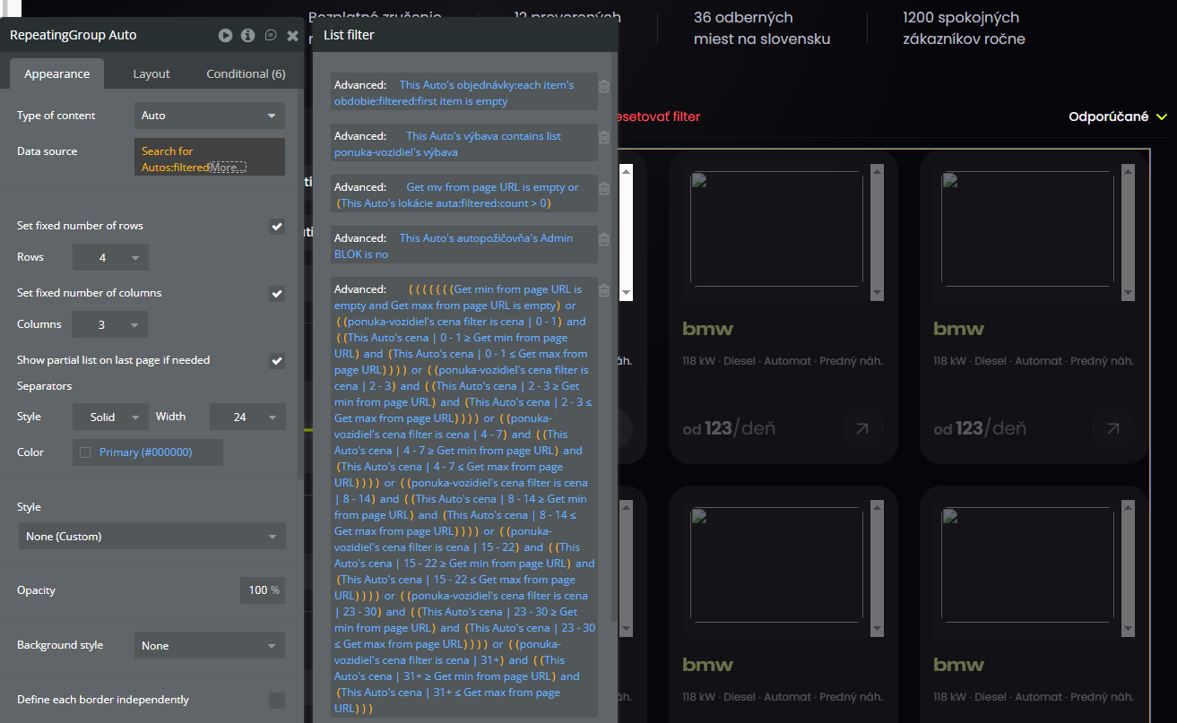

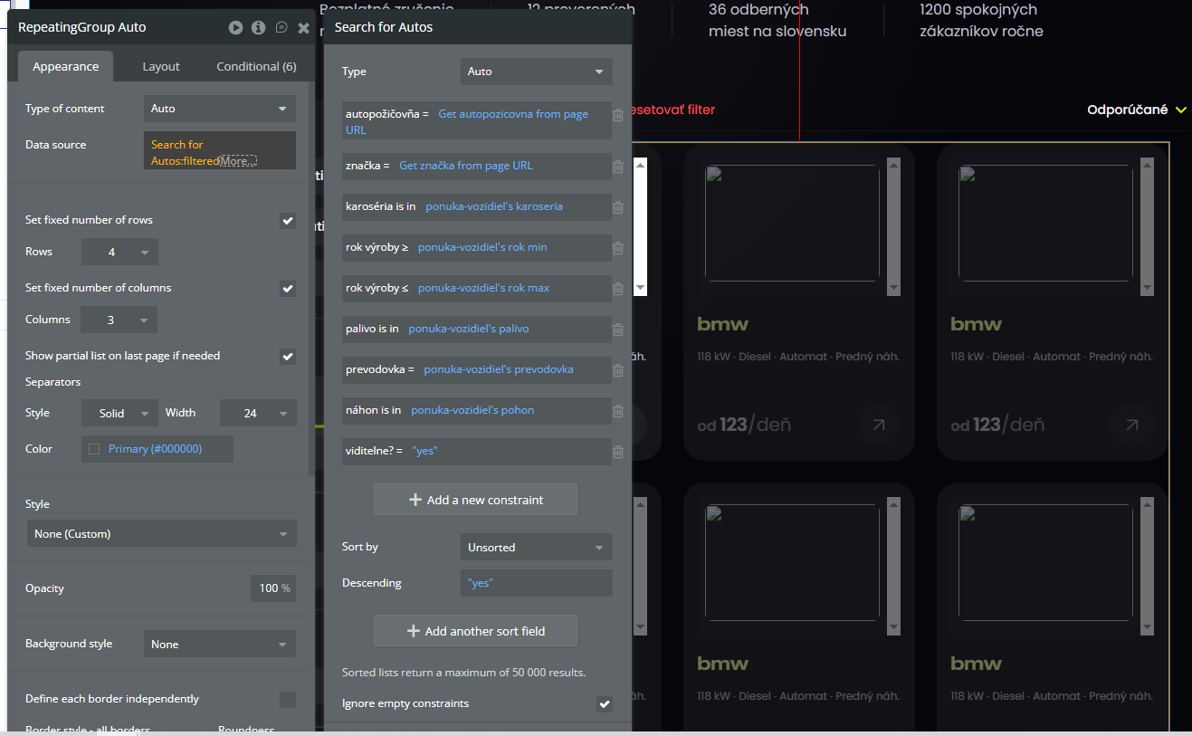

I’m working on a car rental marketplace and I’m looking for advice on the best architectural approach for a complex search filter. My current search is very slow (10+ seconds), and I need to move the logic to the server side.
My initial implementation used a Do a search for... followed by a large :filtered operator on the client-side, which I now understand is the cause of the performance issue. My goal is to rebuild this properly for a fast and scalable user experience.
Here is the complex logic I need to implement on the server:

Hey Marko,
Change the structure so the Order has a field for the related Auto. List fields are tough to work with and not good if they get long.
Because of this you need to change your search based on the dates the user chooses. This means put a condition on your element so when End Date - Start Date:format as days ≥ 0 and < 3, change the search constraint to point to the price_1-2_days field, and repeat for each field.
After your search for Autos you can do :minus list and search for Orders with the date constraint and the same Auto to take out overlapping ones. (may or not work depending on your privacy rules)
There isn’t such a thing, you just need to optimize Bubble’s native searching and you will be OK. by the end you should have most of the advanced filters and :filtered operators eliminated. Change all of them to native Bubble search constraints if possible.
