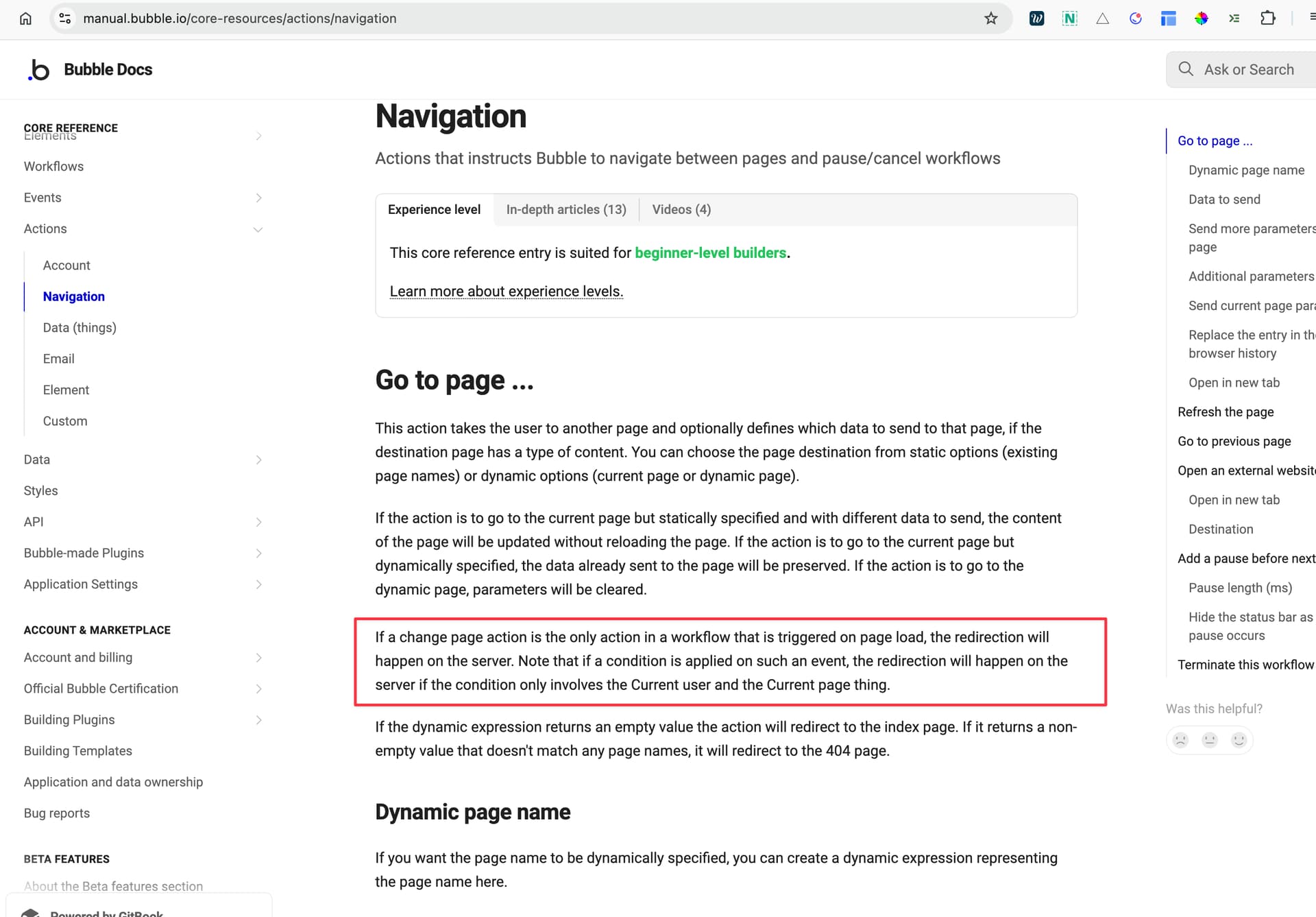

“Do when condition is true” is always client side.
Redo your test using the “Page is loaded event” and my exact expression on the condition for the “Go to page” action.
Side note: Bubble stops evaluating the expression when one part of an OR is true.
I think this was another myth that I tested a while back, but maybe I’ll get a chance to hop on today and find out.
Would love to know what you find. My understanding was for WU efficiently you frontload the “lightest” conditions first so as to not incur the whole cost of the expression. It wouldn’t really make sense to have ORs and ANDs otherwise, right? If my example expression doesn’t stop being evaluated at that exact moment then that would be the equivalent of using AND instead of OR (Edit: Actually I can see how it might be possible to separate this, since Bubble is using an abstracted “interpreted” language as the “middleman” between our expressions and the actual JS, nvm on this point. It would depend on the extent to which expressions are “chunked.”).
In this particular instance it doesn’t really matter for securities sake. Let’s assume it stops immediately after Current user is logged out, okay your redirect goes through. If it needs to evaluate the whole expression, okay it’s still true. It’s all done serverside anyway unless you add a client side condition, in which case for whatever reason that clientside condition is evaluated first, breaking the serverside redirect.
Since it’s being evaluated on the server, the client never sees the “progress” of it, it’s either evaluated or not evaluated in either case.
Very interesting. Just tested, and if I use page is loaded with condition the current user is logged in and current user role is not X, it does do a 302 redirect.
Yup, the only way to break this is by adding another clientside condition on it, or to add another action to the workflow.

The reason we did it was for efficiency. In normal logic, for the expression ‘if P or Q’, if P is true, then we don’t need to check Q because the expression will be true regardless. The general idea is that Bubble does the same optimisation (and doesn’t evaluate Q if P is true in this simple case).
I just did a very simple test and it looks like this is true. For expressions:
P or Q :white_check_mark:
e.g Do a search:first item is not empty or Current user’s X
P or Q or R :white_check_mark:
e.g Search:first item is not empty or Search first item is not empty or Search first item is not empty
Good to confirm.
Seems that the docs hit the mark this time … :rofl:
