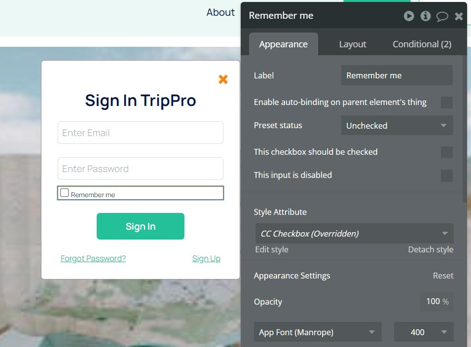

My current Settings
  1. “Sign In” workflow saved as “Remember the email” and “Remember me is checked”.
  2. Preset status as “Unchecked” on Index page setting.

  1. As a user when I sign in and tick the “Remember me”, system remembers the email the next time I log in but
    • The Remember me is not “ticked”
    • User can’t clear the email by unticking the “Remember me”
    • As long as I tick remember me once, the email auto append in the email box and I can’t get rid of it unless go to Incognito. But same issue happen in Incognito once I tick Remember me upon signing in.
If I did not tick the Remember me at all, system is working as intended.
Can anyone guide me how to achieve this?
