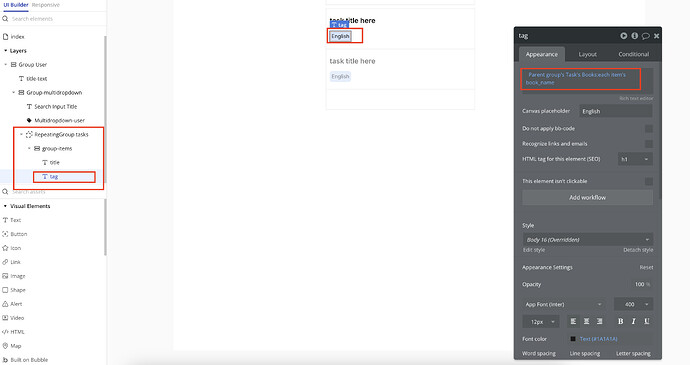

Thanks for your reply @hi.luisacosta here is my code, please feel free to check
Oh I see, the issue is your formatting not the data. You only have 1 text element for the tags, so all the words are showing up with the same background, and there is visually no whitespace between the words.
If you want it to seem like multiple tags then you would need to use a repeating group to hold that tag text element. Try that.
it works, i use repeating group of “books” table and use data source of “tasks” table, which is working fine. @hi.luisacosta thanks once again for your prompt reply.
