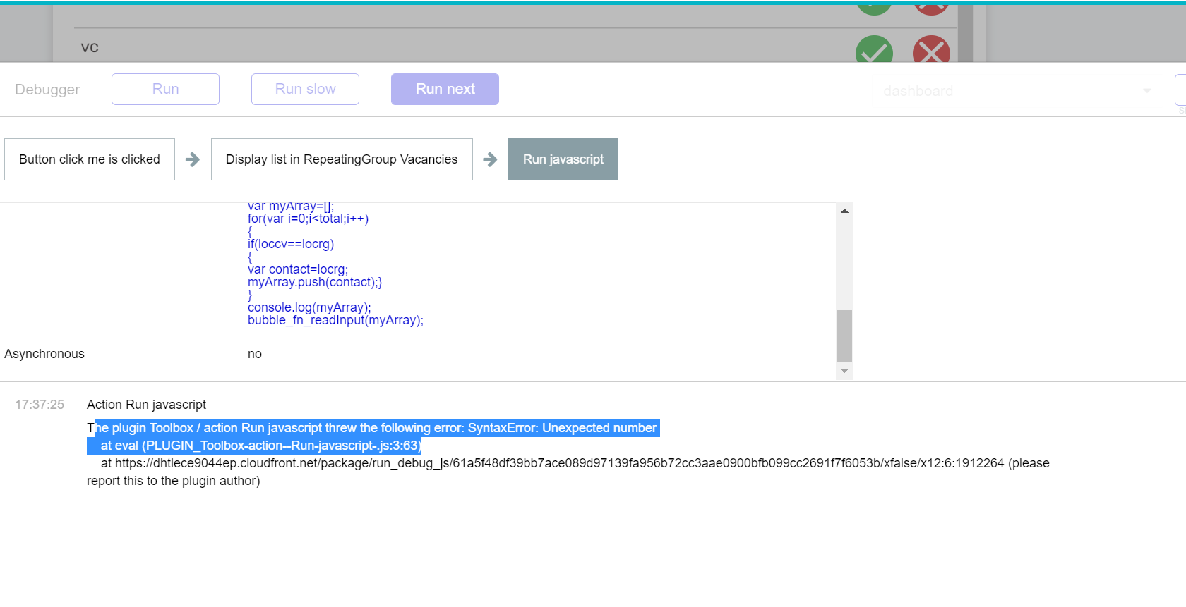

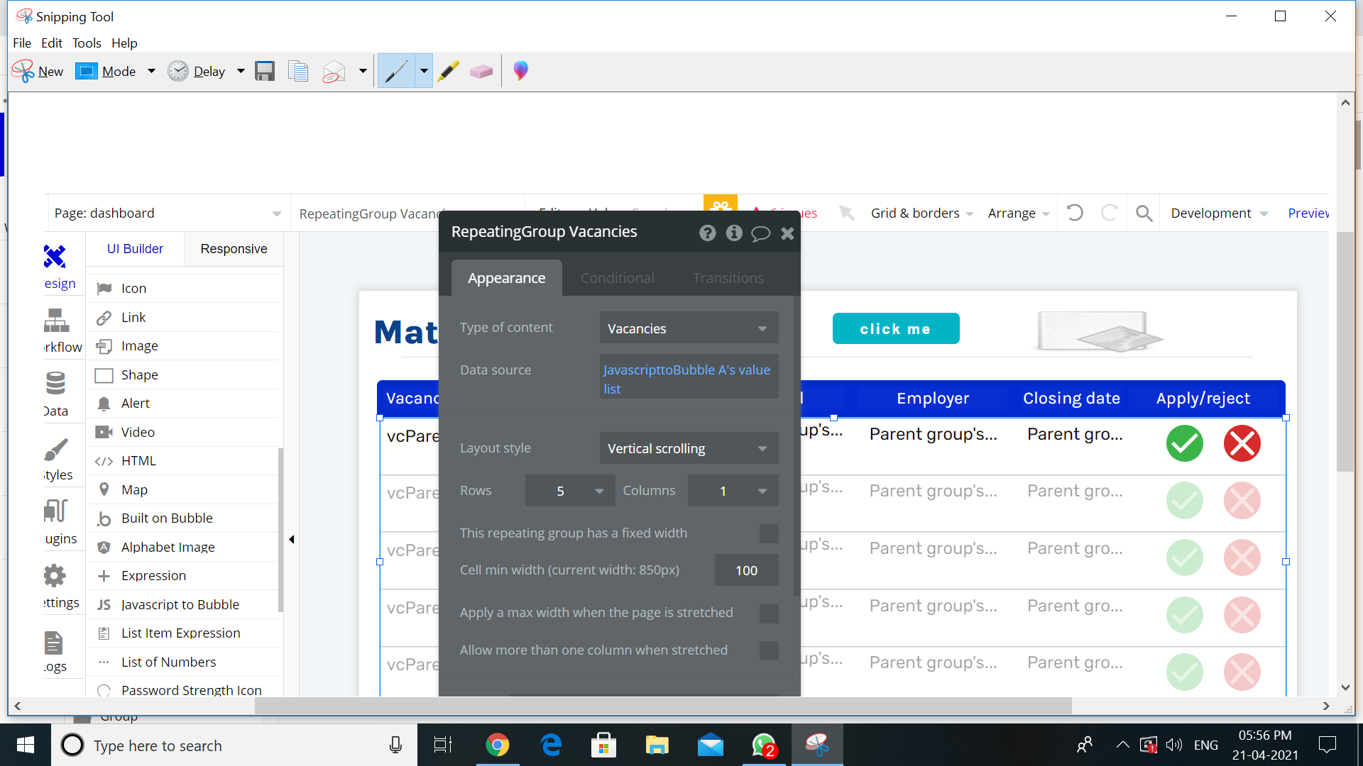

I want to filter the reapeating group using javascript and I have two pages digital cv and vacancy and I have to match some attribute of it …when I click a button then it should display me filtered repeating group… and I am not able to show that filtered values into that repeating group using javascript bcoz not able to store table and its value in a variable …so that I can compare it please help me out!!!
getting this error
getting this error
