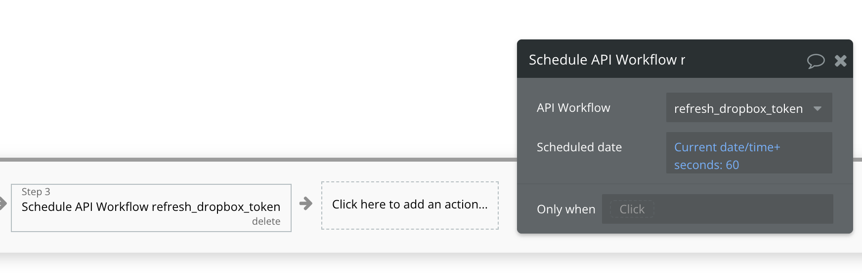

However, I’m getting stuck here and it does not appear to be working in my attempt… here are some screenshots of what I currently have in my workflow:
From reading the instructions, it seems like what I have here should cause the workflow to run every 60 seconds, refreshing the token value in the database, yet this does not seem to be happening…
Can anyone help me understand where I’m going wrong here? Thanks so much.

Seems like the problem is more that this is never running at all. Is there some way I need to kick off the initial run so that the recursive scheduling process can happen?
Yes, I assumed your first screenshot below was triggering the WF but that certainly needs to happen first. You can set a button on a page or any other click or elements to trigger the initial call of the WF.

Ahh yes, thank you this is was the problem. I decided to go with Bubble’s native file storage instead of Dropbox in this case, but good to know how the recursive workflow functions.
It does seem like the necessity of client-side scheduling of the workflow should be mentioned in the documentation, which makes it seem like it’s a purely server-side solution for recurring workflows.
