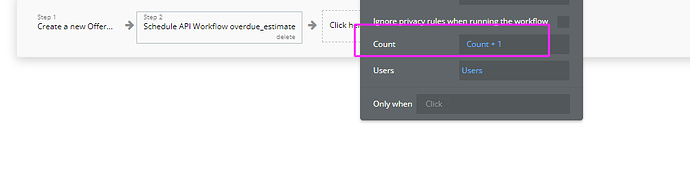

What you’ll need to do is to run a workflow in the back-end. For each user, you’ll want to trigger a notification. The list of Users has to match the criteria for them to receive the notification. Small example below.
To summarize the screenshots, you keep scheduling the api until the Count is equal to the Users count. Each user in this case, has a new offer created for them.
If the list is huge, make sure you schedule the next one at least +1 seconds later than Current Date/Time.

No, I mean you need to run the workflow on a list (use schedule API workflow on a list), not that you need to have a list field on the datatype.
I’d recommend doing that itself on the backend to avoid timeouts, but even then, depending on the number of Users involved, using a recursive workflow (as @nocodeventure has outlined) might be a more stable option.
That said, if it’s just a few dozen (or even a few hundred) then running the workflow on a list should be fine (at least in my experience), and certainly simpler to set up.
So, keep the backend workflow you currently have (make sure it has a parameter for Recipient, of type User), and schedule that workflow to run 'on a list from another workflow (preferably a backend workflow), and define that list as your list or Users.
Alternately, setting up a recursive workflow will also work.

The Type Of Thing should be ‘User’
The list to run on should be the specific list of Users you want the workflow to run on (i.e. something like This Company’s Users)
The Scheduled Date should be current/date time (or whenever you want the workflow to begin)
User should be ‘This User’
And any other parameters you need for the workflow should, of course, be whatever they need to be…
