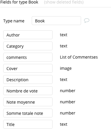

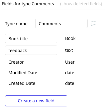

Thanks for your reply, you will find here below some screenshots of my database and the workflow used to store comments, my issue is that i don’t know how to do to have the book title in the comments data type
Capture d’écran 2020-06-02 à 10.36.03 Capture d’écran 2020-06-02 à 10.36.21
I have set up a group with information like author, title …etc.

In the workflow of the button i created a new things for “comments” data type and i linked it to the “feedback data field”. The feedback are stored in the comments database but i don’t know how to do for the “book title” which is linked to “book” datatype
Capture d’écran 2020-06-02 à 10.39.38

So if you set another field from the submit button step 1 you can choose
book title = current page book
Maybe you should label that field as “parentBook” instead of “Book title” as it may be confusing.

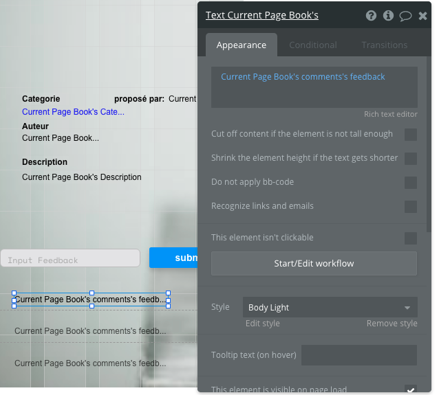

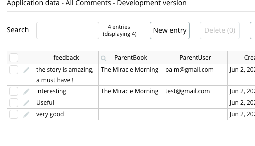

I have just one remaining issue, i have set up a repeating group to list all the comments. I would like to have one comment per row but it seems that all the comments are listed in the same row.
I have put here below the screenshot of the comment database and the repeating group
Capture d’écran 2020-06-02 à 23.11.02

No problem. It should be the current cell. Not the current page. That should be what you are looking for. :blush:
Thank you very much for you help, everything is working fine !!!
