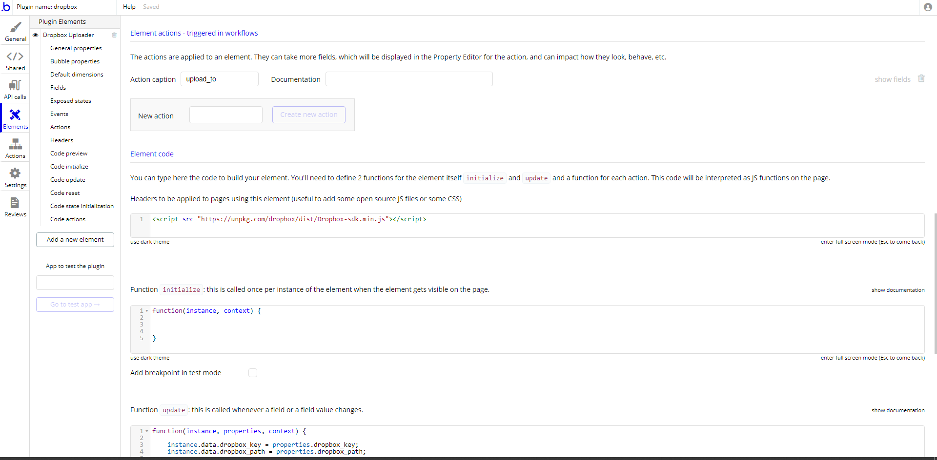

Hey! @leonidas.petrou4 The best way to do this is by using Javascript SDK as I mentioned before.
As @neerja suggested, you need to create a custom plugin (you need javascript knowledge to do this).
I created a piece of javascript code that should do what you trying to do:

No Toolbox or any other external plugin. That screenshot is from plugin editor.
About your question, actually, you can upload to any Dropbox account as soon as you have the API-key. In this case, I’m using my API-key but you can change the field using dynamic value:
About the editor, even if I send you the link you will not see anything because the code that uploads is not visible (which is visible in the first screenshot).

Yes, but you don’t have to figure how to do it cause I already did for you (the code on the first screenshot).
You only have to copy that code in your plugin (create one from https://bubble.io/my_plugins) and set up the fields.

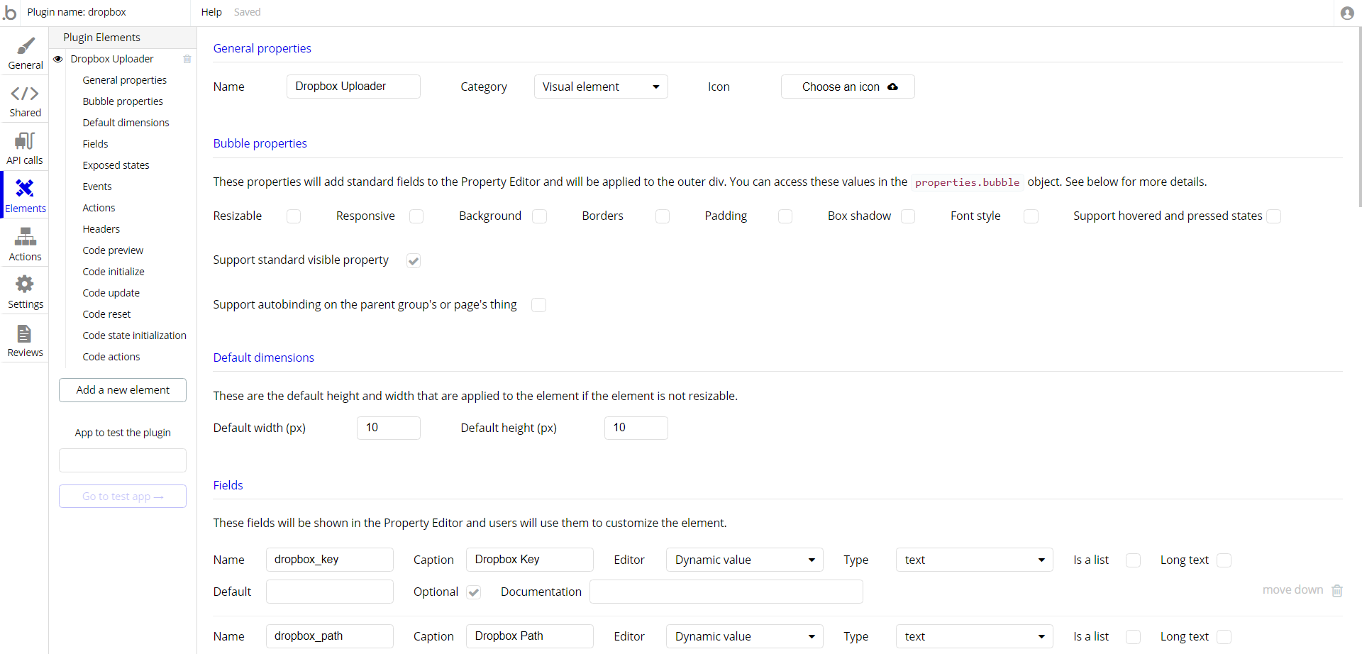

Thanks @yusaney1 , so I’ve managed to create the “upload_to” Element action - triggered in workflows where I added in your code. I then added the dropbox_key and dropbox_path in the fields and defined their types. I did all this in the “Elements” tab in the plugin editor. I have managed to authorise the private plugin and install it in my app. However, I think I am still missing a part of the plugin setup. Specifically, where do I define the file to be uploaded? I.e. where do I reference the file uploader / the file to be uploaded.

For anyone interested, this was @yusaney1’s Javascript plugin solution (see screenshots below).
He was kind enough to help me get this working. This works great to upload files to one Dropbox account (the account of the generated token) but not to each user’s private Dropbox account. Unless users create their own Dropbox developer accounts, app and token which they would then input into my app. This can work, but it is not a seamless user experience and will be tough for non-technical users. So unless we use User Authorisation, this problem remains unsolved :frowning:
