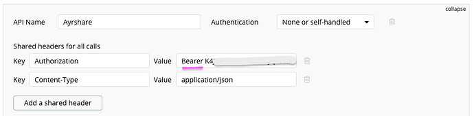

  • open the Plugins tab
  • click on API Connector
  • Add another API > give it a name (I called mine Ayrshare)
  • Set Authentication to “None or self-handled”
  • In the shared headers for all calls, add two shared headers
    Key: Authorization Value: Bearer (your API key)
    (don’t forget to add Bearer in front if you want this to work.)
    Key: Content-Type Value application/json

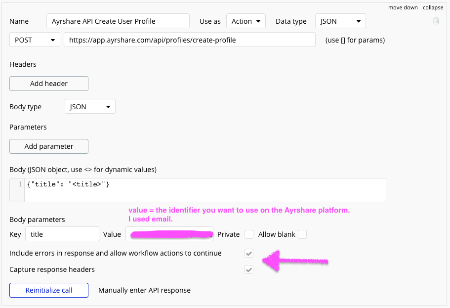

Create user profile (documentation)

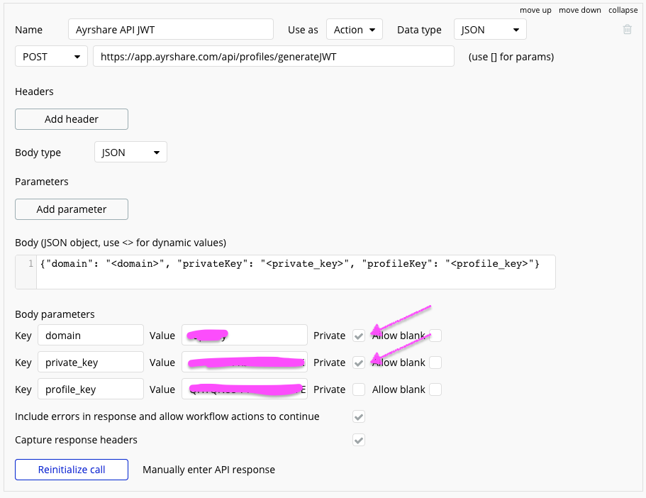

Generate a JWT (documentation)
You will get the domain name and the key from Ayrshare upon signup. I recommend to keep these private.
The profile key is unique to each user - uncheck private so you can add this dynamically on each call. You can get that from the Ayrshare account when setting up under user profile > profile key.

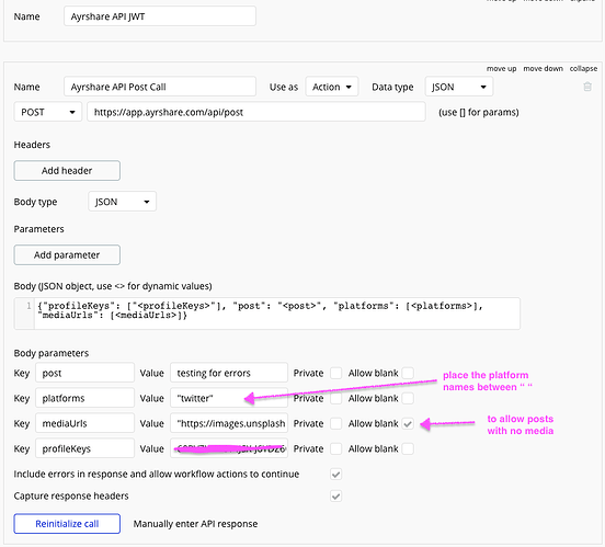

Post (documentation)

Thanks @dee we were able to setup all the calls except generate JWT,
Everything works fine in POSTMAN though.
I had a few issues setting that one up because of the Key. Probably best is to reach out to @gbourne who can help you with that.
Hi @technoswift - here are the Bubble-specific instructions on how to generate the JWT Token.
https://docs.ayrshare.com/packages/bubble.io#generate-jwt-token-in-bubble
Thank you @ayrshare team, this works perfectly.

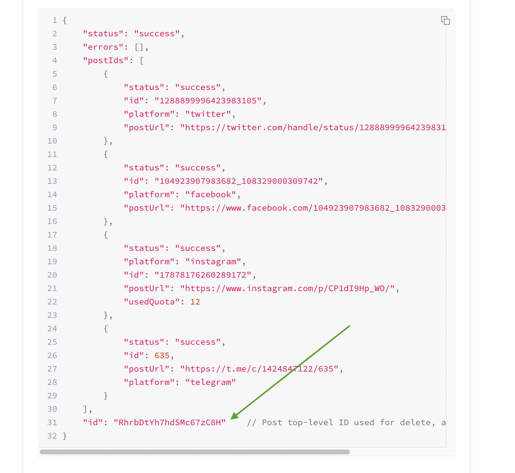

Hi, I have been trying this but I keep getting a “Delete ID not found”. I have tried every single id that is returned from the post API call.
On this page https://docs.ayrshare.com/rest-api/endpoints/post
Click the > next to the api endpoint to expand it.
Then click the > next to the 200 response.
You can see the sample response. Use the id that the arrow is pointing to…
Thank you for this explanation. I tried this Id and it looks to be working. Appreciate the quick response.
Hi @dee @ayrshare
Thank you so much for this tutorial! It’s really helpful. I’m stuck on the “post” call. I’m following exactly your body and meet the issue “Twitter is not linked with Ayrshare. Please confirm the linkage on the Social Accounts page in your dashboard.”
What might be a problem? I tried to connect Twitter through the dashboard but still had the same issue. And moreover I want to post on my users behalf. Why do I need to connect my twitter? I would be really grateful if you could give a hint where should I look for my solution
Here is the body of the call
“profileKeys”: ["< profileKeys >"],
“post”: “< post >”,
“platforms”: ["< platforms >"],
“mediaUrls”: ["< mediaUrls >"]
You need to go to the dashboard at app.ayrshare.com and connect your Twitter account before you can post to it. If you continue have an issue, please contact Ayrshare support directly at support@ayrshare.com.
Thank you! Twitter is connected, but the issue is still persistent. So I’ll contact support :slight_smile:
Twitter should be connected even if I want to post on the user’s behalf, right?
