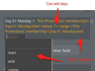

I’m stuck at a problem with Date Range that confuses me. When you edit a date ranger, you can edit the :start part as much as you want, but Bubble doesn’t allow manipulating the :end of the range.
Take a look at the example below. You can add 7 days to the first date in the range just fine, but if you try to manipulate the :end part, the dropdown shows the following:
Is this a bug, or can’t ranges be manipulated in this way?

I’m using the date ranger to see if the current time is within an appointment’s from-to time, and show it if it is. And to move the appointment X number of days into the future, I need to be able to edit both the :start of the range, and the :end. But bubble only allows for the :start to be manipulated, as far as I can tell.

You are right, it doesn’t seem to work that way.
A bit of a hack … (but it works)… create the range, with the “end” date unmodified. Then makes changes to the thing, and switch the placing of the start and end, so you update the end date first… and leave the start at the end, untouched.

That would do the trick, even if it’s a bit of a hack, yeah :slight_smile: I didn’t think of that, thanks Nigel.
I’ve reported it as a bug, so we’ll see what they say.
