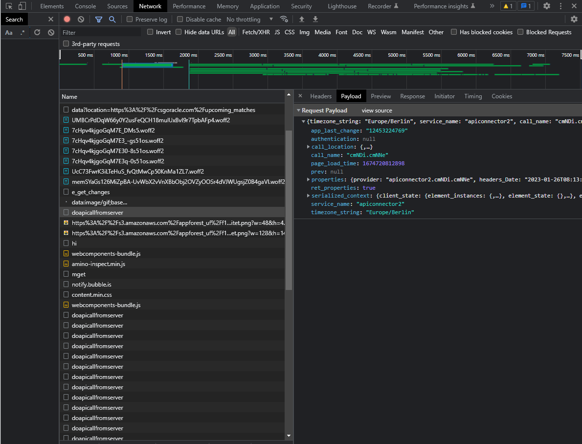

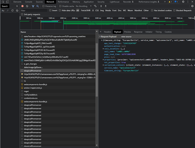

I set up my api calls in the Bubble’s API connector with private keys in header and they’re working. There’s no problem with the keys. If you look at the network tab in the website, you’ll see that Bubble makes POST calls to “https://csgoracle.com/apiservice/doapicallfromserver” with no Authentication ?! It is set to NULL.

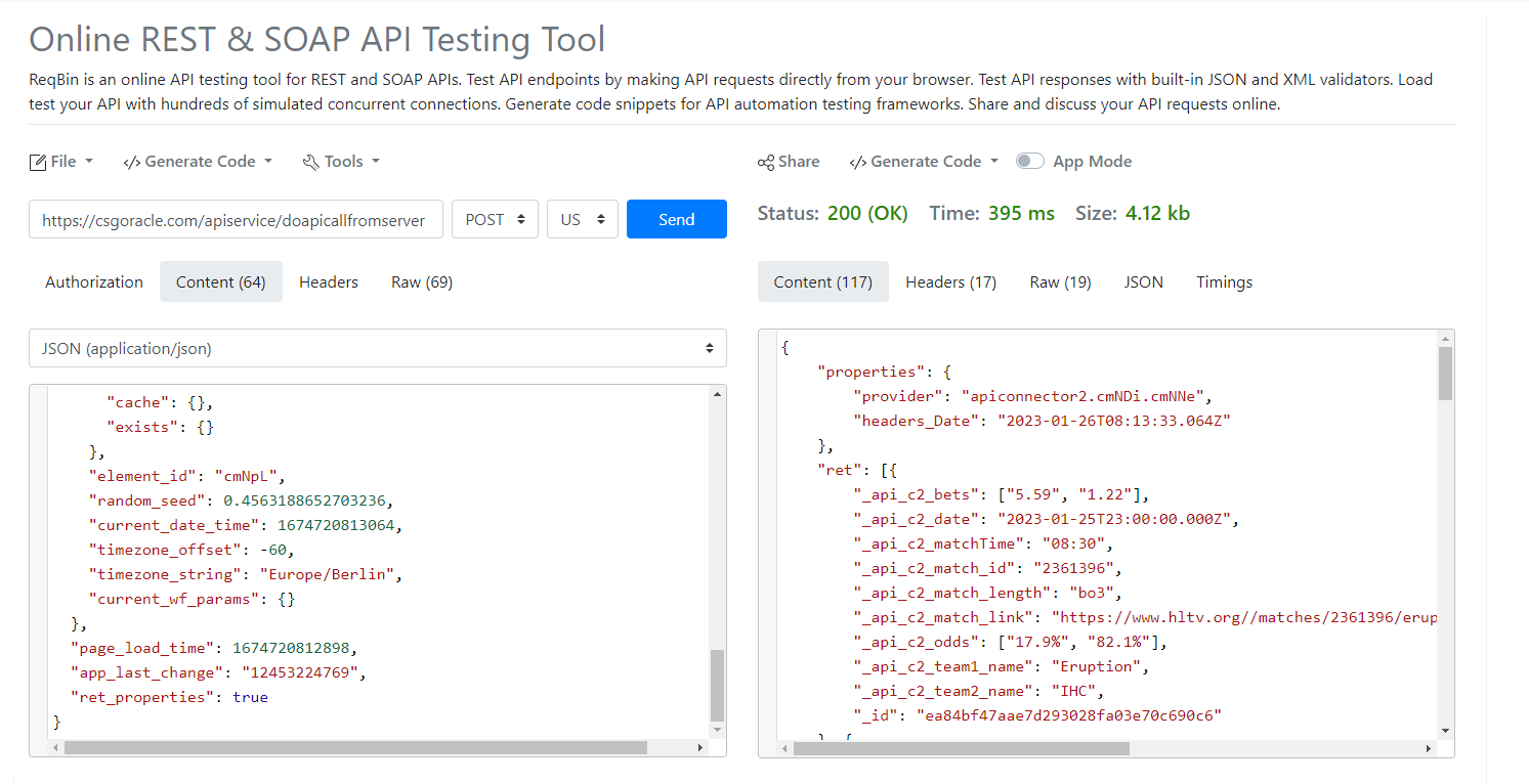

Anyone (I really mean it, even you) can make a post call to “https://csgoracle.com/apiservice/doapicallfromserver” with the payload shown on the image and get the private data which should have been only accessible through my website. I already tried! See:

Those api calls are made to my endpoint on PythonAnywhere. They are responsible for getting data from there.

Well, the problem may be caused due to the endpoint on the PythonAnywhere. Because I set it up also, I may have done some mistakes. But, even if that is the case, why do I see “Authentication:null” in the network tab? Bubble seems to be making an api call with no auth at all.

I don’t remember where I read this, but I believe the only reason you’re seeing “NULL” in the authentication is because Bubble is hiding the private key.
