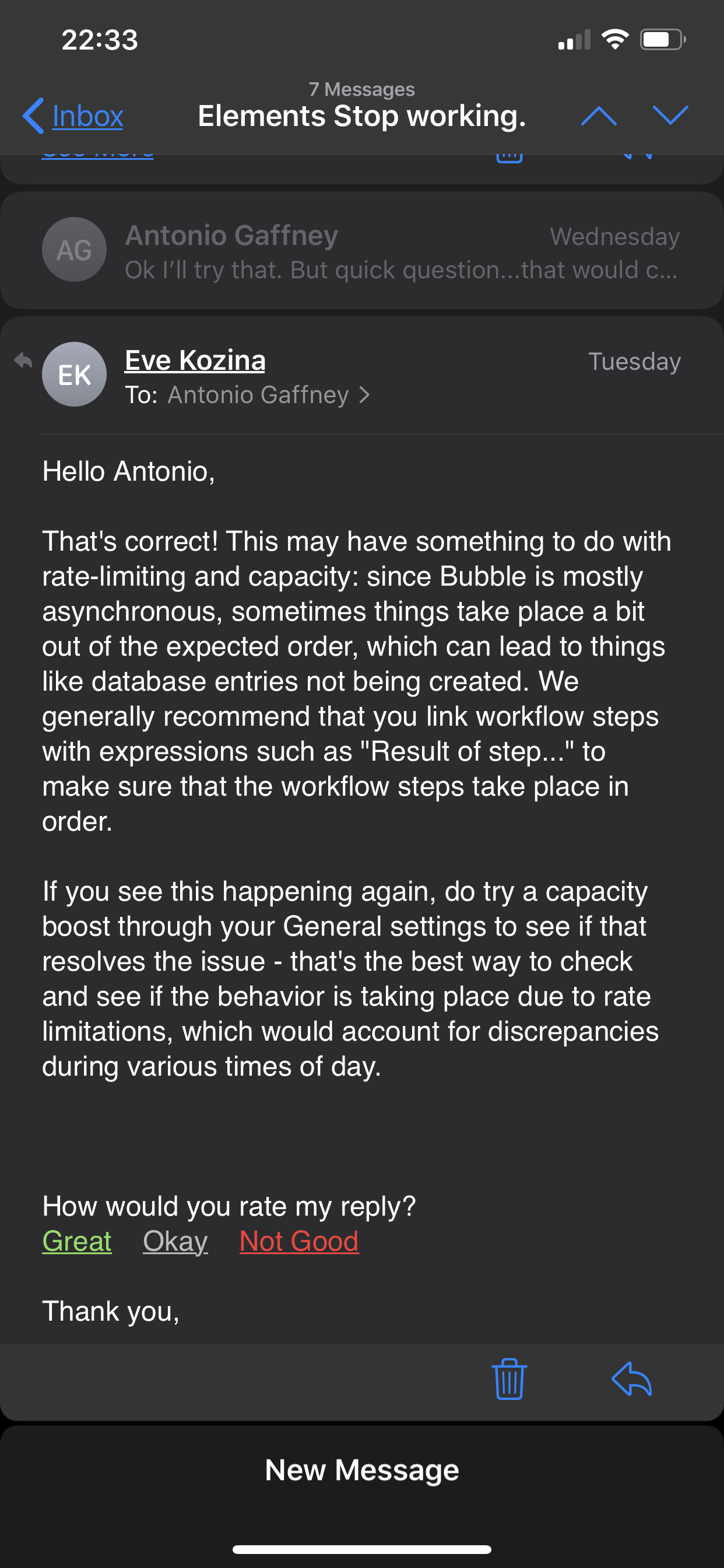

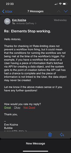

I reached out to bubble and explained the situation and this was their response:
My question is, as a non programmer, with no knowledge of the inner workings of code and/or organization of WFs, how am I supposed expect to have success with bubble? Because when I initially create the WFs, they work just fine. It’s only after constant testing that this occurs. What’s worse is that it transfers to the live environment as well. So does that mean if the WF is constantly ran in live mode, it could potentially occur as well? It’s to the point that it’s happening every week now.
