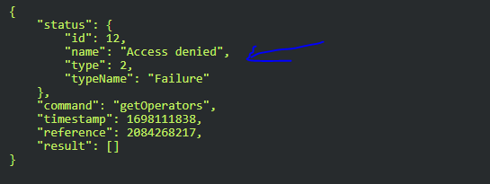

I have this API to integrate but it has a pre-request script that is used to generate the passwordhash, I am not sure how this can be done in the bubble API connector.
Hello friend. What is the response to this first API call?
Access denied
