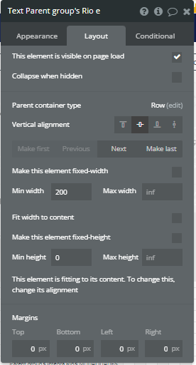

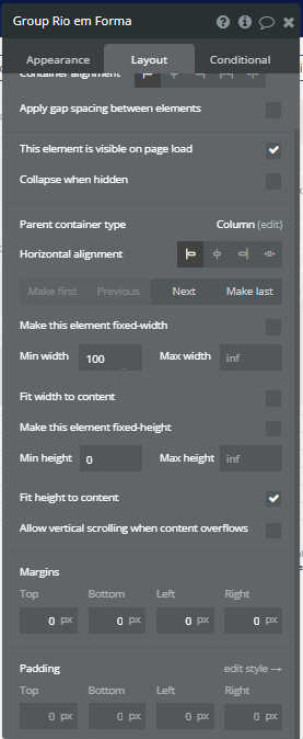

  1. With this image we can’t see the exact size of the parent group to judge if the icon is, in fact, out of alignment.
  2. The parent group have any padding?
  3. The icon have any margin?
No padding, no margin
What about padding/margin of the parent group?
Bubble are setting padding automatically on various elements
