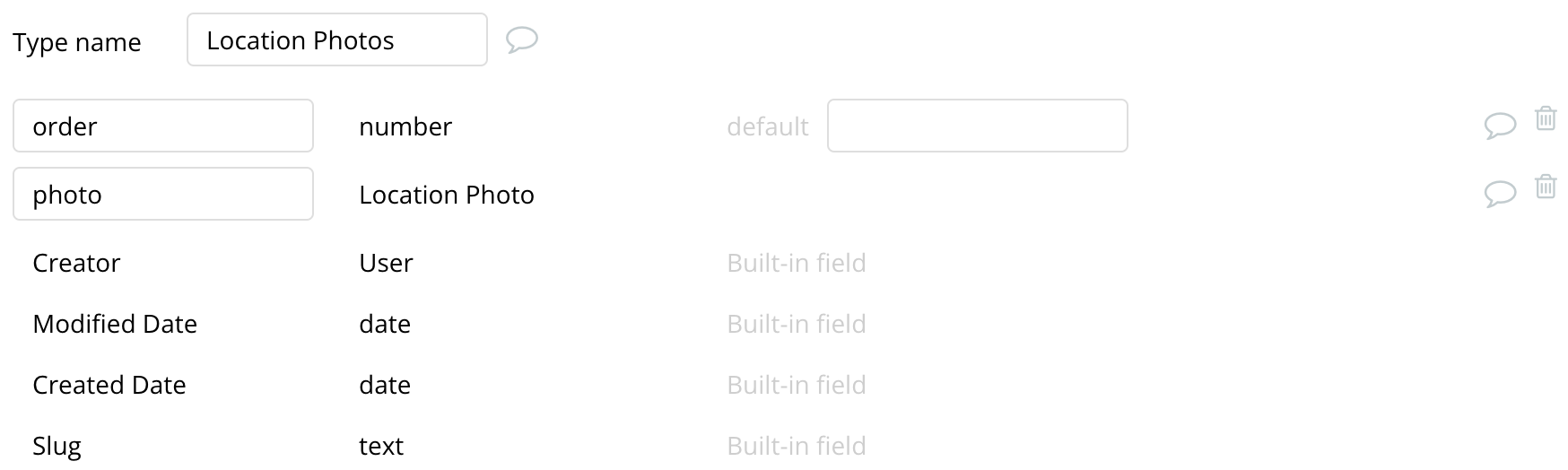

Option 1:
Location with a list of Location Photos
This feels easier but I’m worried that on pages that load all locations, it means it will load all the images of all the locations as well, which feels risky. Or is the degree of separation by having the image itself on the Location Photo data type enough?
The dual way ownership will also be annoying to manage during creation.
Option 2
Location with a single Location Photos with a table of Location Photo
This feels like it would perform better but is more layers to manage.
