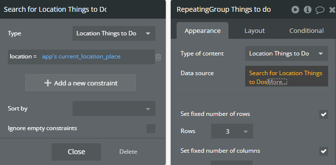

When a user searches for and selects a location, the workflow animates the location page and does a search for the location, and sets it to a state on the page called “current location.”
On the location page, I have multiple repeating groups that all do a search using the index’s state current location as the condition inside the do a search.
I show all location amenities for the location, but only the first 3 things to do, quick tips, and location images.
