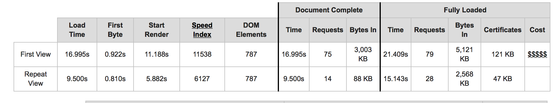

Here’s what a summary load time is currently looking like:
While we do have some heavyweight items on the page (video background), it still looks like too much.

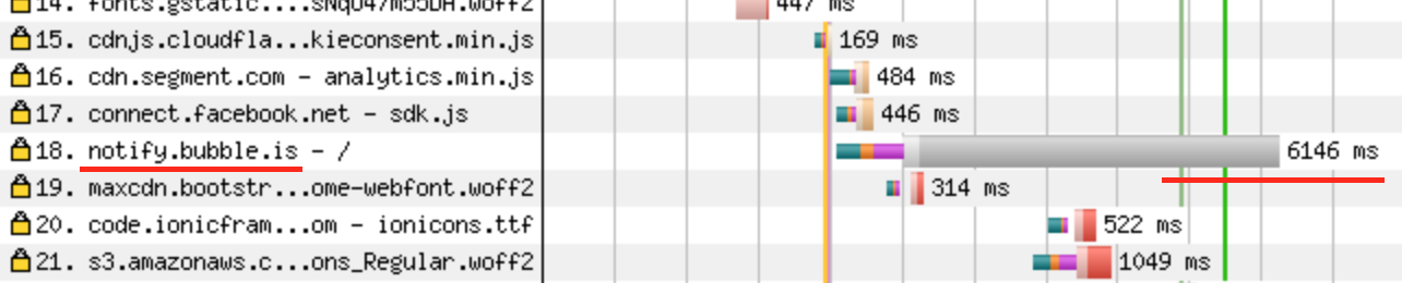

The breakdown of loading time shows the following step taking the biggest chunk:
The other bigger items are related to youtube video loading, but they take 1-2 seconds max each as per the report.
Any suggestion what this may be and how to improve the load time?

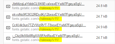

What I also found out is that site loads one font several times:
Does anybody know how to avoid that?
