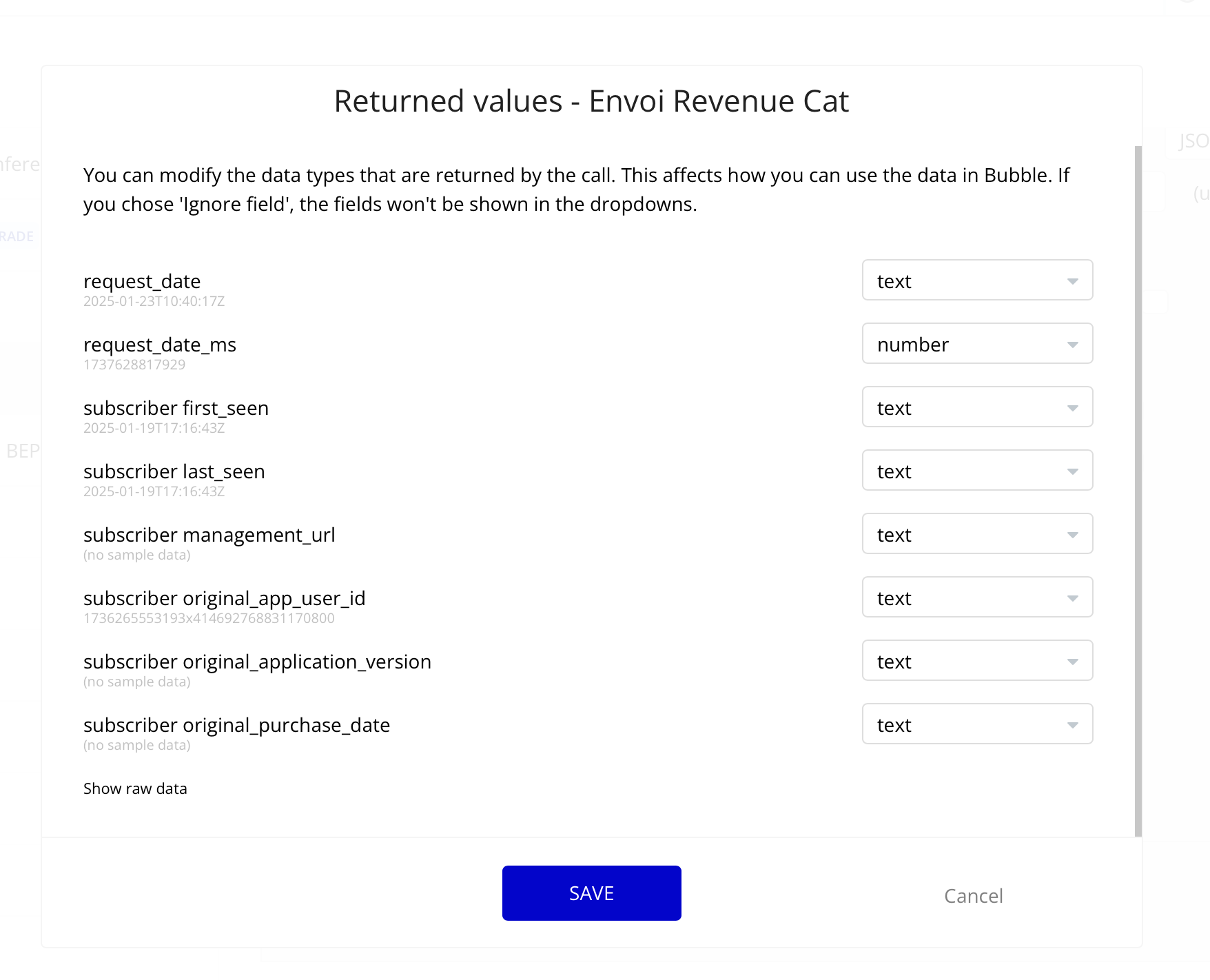

I’d like to ask you a quick question. How do you find a user who pays for an in-app purchase, knowing that you retrieve the purchase data via a webhook from Revenue Cat, and in the backend workflow you can’t link the data to the user who clicked for the purchase? When you make a purchase, do you send Revenue Cat an id that the user has in Bubbe (unique id), and when you retrieve the data from Revenue Cat via the webhook, you find the id that you sent to Revenue Cat (API GET or POST) and you can assign it to the user?
You have to make sure that you set the revenue cat ID yourself otherwise it will assign an id for you. Simply set the id to the user id and you can match them.
Thank you very much sem for this reply, I’ve been trying to solve this problem for several weeks now, and it’s very difficult for me, even though I know it’s not complicated at all, but I’m not comfortable with APIs. I can’t match the user’s unique id on Bubble with the RC id because after payment I receive the user’s RC id on my workflow backend (webhook) and at that point there’s no proof that it belongs to the user who paid. Basically, if everything happened on the workflow and not on the workflow backend, I’d be able to do everything without any problem, but I can’t get the payment data from my workflow. I’m exhausted, I assure you. A little help to solve this problem would do me a world of good.
You have to look for the build natively Purchases element and put that on your page. Make sure that you call this to set the ID BEFORE your customer makes a purchase or calls the RevenueCat API. As soon as you let anywhere in your app call the RevenueCat API without setting the user ID first it will assign a revenuecat ID.
Also look into RevenueCat aliasses as it will add as many ID’s to a user as you or another process adds. So you will find an array of user ID’s from the past and current one. So you can add to any user the ID (for instance on login you can always check if there is the bubble user id in there or not, if not simply call the Purchases element and add it).

Ok, I don’t use the NATIVELY plugin. How do I send an identifier to revenue cat with an API call ?
Hi,
When you are not familiar with API calls it will get difficult. So either you have to find some tutorials about it or ask someone to do it for you. It is not hard, but you have to know the basics. So if you want to learn give yourself a day, sit back and relax, take a cup of coffee or something and enjoy a day learning all about API’s and the Bubble API connector.
For instance, the picture you showed is a GET api (for getting things like information from RevenueCat). If you want to send something to revenuecat you need to post things so a POST request.
About not using build natively plugin…not sure how you use the SDK from RevenueCat then. So if you use build natively as a wrapper for you lr mobile app, use their plugin actions and states.
