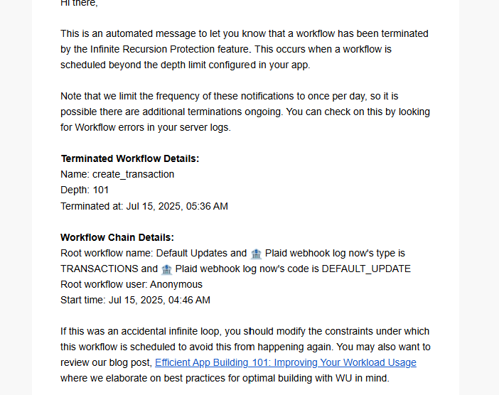

So I have budgeting app that use plaid to pull transactions. I am currently using @lostsheep plugin to use plaid and pull transactions.
The transactions is going into an infinite recursion loop since it is alwasy pulling transactions.
@lostsheep gave me some directions on how to possibly deal with it. However, it is something I have never really done before and I would hate to break one of the most important parts of my app. But I also want to avoid allowing the depth of WF to be high and not have the recursion protection when I need it. Lost sheep said it was beyond his scope for the plugin so I am reaching out to see if anyone could help.
This is the current setup and what Lost Sheep told me to do.
ps. I did read the bubble doc on schedule api wf as a list, but it is not helpful. I need to know what is the outcome I am actually aiming for for me to figure it out.
update: that database trigger schedules this WF, which is where the recursion is happening.
