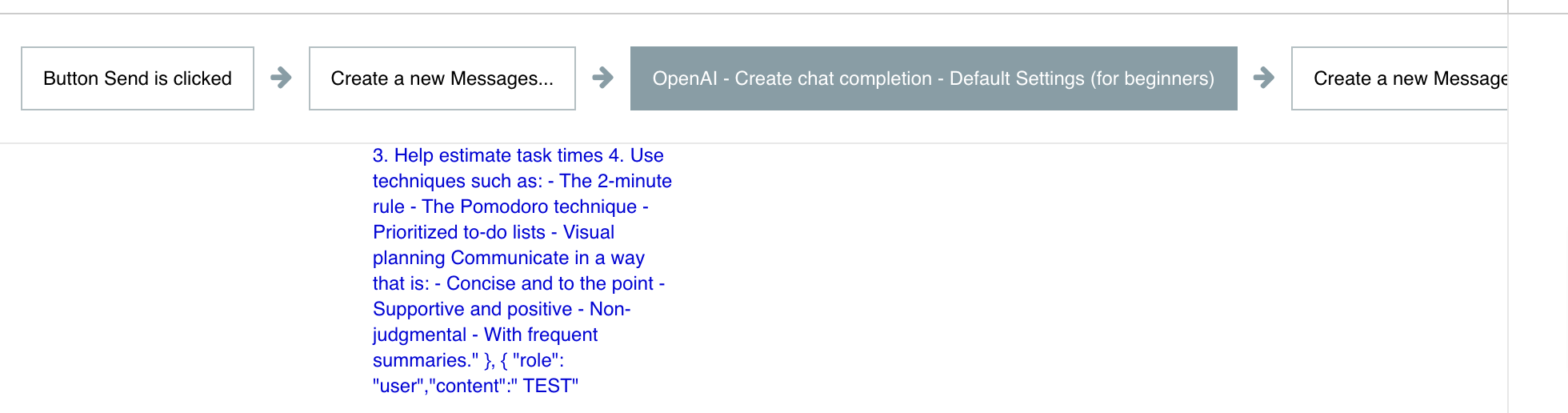

- Dynamic Values: I’m passing dynamic values (user’s input) into the message body, and I can see the correct values being passed through in the debug logs. However, the message from OpenAI is not being returned or saved into the database as expected. (I can see my own message in the database, but not the OpenAI answer)

Your JSON markup for the API call is invalid hence it can’t initiate an API call to OpenAI servers.
for dynamic input field markups always try to use plain text letter or words, here you used an apostrophe “Input Message’s values” - the apostrophe is causing the JSON syntax to brake and cause issues.

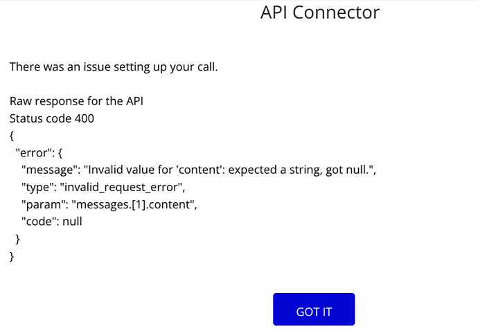

Thanks for the reply. I changed headers to private. But when I get rid of the apostrophes then there’s another error coming up:
I assume you got rid of the side ones as well, just use this exact thing : “<input_message_value>” - with the apostrophe on the sides as these are important and identify itself as value containers, any apostrophe used inside these value container in the dynamic words breaks the API syntax and hence your api call doesn’t work.
Just use this: “content”: “<input_message_value>”

@sparklsophie You should be using the following in your API call.
"content": <message>
In the API call, you need to fill the message parameter with Input’s value:formatted as JSON safe.
That ensures that no matter what the user inputs, the message JSON will always be valid.
To pass a variable to an API call, you create a parameter (like you have done for one called ‘Input Message’s value’. When you use the API call action, you need to enter the dynamic data there. I think you might’ve misunderstood how passing dynamic data to API calls works which is why you’ve hit a wall

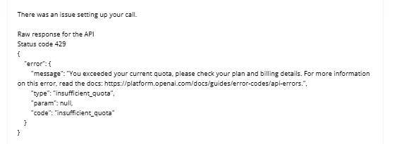

Forgot to add the bearer keyword before the token, but the issue I’m getting now (I’m aware about the error code 429, but still mysterious for me how I exceeded the rate limit ):
Read the docs at the link provided.
