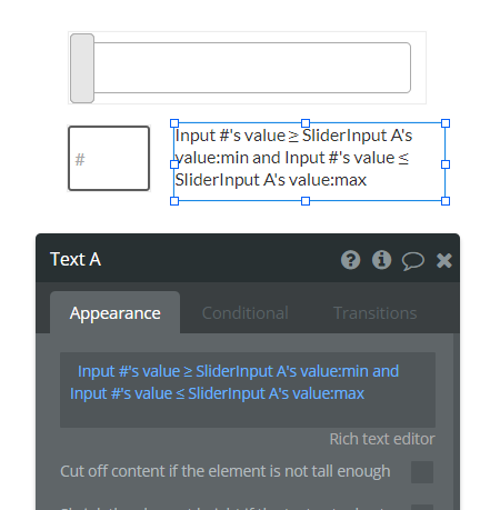

I never actually realized there’s no “is within range” modifier like this. Seems like you can only do it from the other direction: range contains point.
You could try the below, but seems like more work if you can just do “range contains point”.
is-2017-08-23-23-16-09

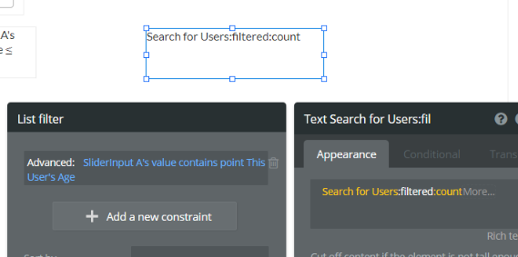

If you need it in a constraint, I think you’ll just need to use an advanced filter:
is-2017-08-23-23-19-53
