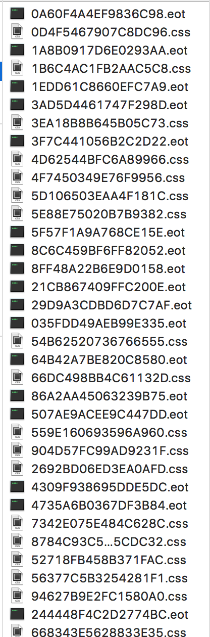

The issue that @isaac and I are having is that the css folder has to be in a certain position within the website. This is for security purposes where Typography.com won’t let the fonts load otherwise. Here are the exact instructions:
Then here is what the whole folder looks like to give you some reference of what we’re dealing with.
Based on this info, do you still suggest the same advice?
Thanks,
David
Ah, I see what you’re saying now. It has me rather stumped, to be honest. Based on the screen shot it looks like it’s possible to change the location where they are stored, so I would imagine that you can upload them to the test app and then change the location later to your actual application’s domain name.
