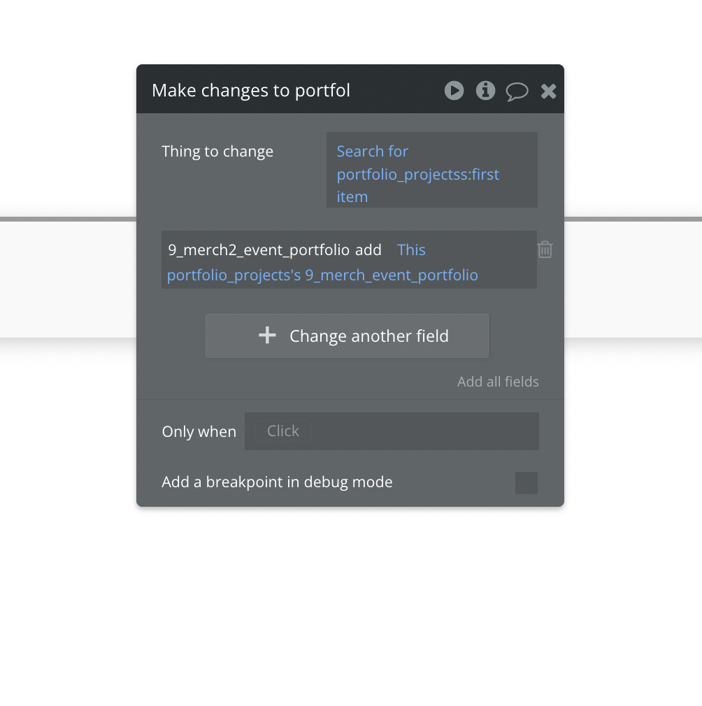

hi there.
i have the similar issue.
I wanted to change data field type from text (A) to list of texts (B).
I tried follow your instruction but it’s doesnt seem to work on my end. If you could take a look on what to fix for the workflow i’ve done?
