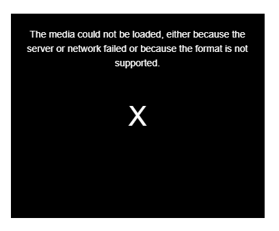

It’s an MP4 file. This is what I get. I even tied it with a static file.

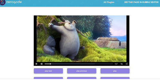

This one seems to play nicely.
True, I went with the other one for the better UI but this one does work too

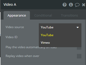

Thanks for your suggestion. Unfortunately for me there’s no documentation or editor view. I don’t understand what’s shown below. These aren’t youtube or Vimeo videos. They’re video files saved to a record in bubble. Will you help clarify it for me?

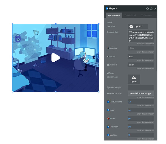

For the suggested plugin, you can use dynamic links for your stored videos in your db.
There’s also workflow actions to control,
Thanks for that clear instruction. My “appearance” tab is different though? Compare your image to mine. Wonder why.
Oh, that looks like Bubble‘s built in one. Should be toward the bottom in the elements tab. Think it’s called ‘player’. Not near my computer right now :slight_smile:

Sorry for the trouble, however, the plugin Video Player works on our side.
We could not replicate the issue with playing files from the database.
Here’s our setup :
And the database (you can see the 12th item in Video thing “Bunny MP4”)
Playback
You can see our demo setup: zeroqode-demo-06 | Bubble Editor
One thing that may cause the issue, it’s the file itself either it is private or corrupted mime type.
Would recommend to check, the files which were uploaded in the database.
Hope this helps. :pray:
Regards,
Zeroqode Team.

Thanks again for all the input. It seems the mp4 files I’m uploading to bubble aren’t working. They play on my pc, but not in any online video player. I checked outside of bubble. They’re extension is .mp4. They come from a 30K video recording device. I don’t have any idea what other solution there may be to play these. Do any of you have an idea?
SO, after further investigation I found “MPEG-4 video codec which is not supported by browsers. The only widely supported video codecs are Theora, H.264 and VP8.” The files I have are MPEG-4.
For anyone else that may run into this issue, I downloaded Movave Video Converter. It worked great. I converted it to mp4 H.264.
