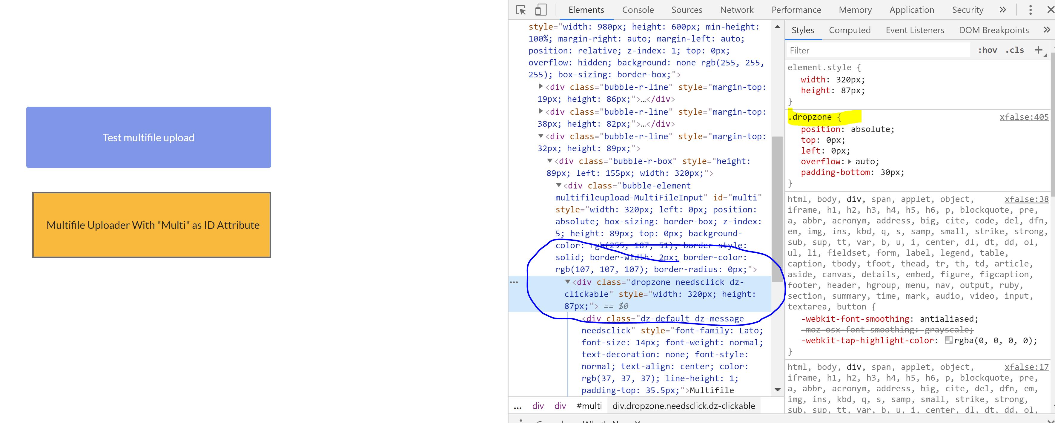

For those who still want to use multi-file uploader(I’ll type mfu for short) with a button or icon or anything clickable, here is a more in-depth explanation of how I did it because the post that addressed it didn’t work for me. I wrote this with non-coders in mind as much as I could. I’m elementary as well, so bear with.
There are three methods I got to work for me, I’m sure advanced coders can find a lot more.
  1. Works for only when there is only one mfu on the page that you want to trigger. You can have multiple mfus on the page, but only the first one (first in order of top to bottom, and if the elements have the same vertical position, then left to right) will be triggered.
  2. Works for the specific mfu that you want based on its order(Again, it’s ordered from top to bottom, and if the elements have the same vertical position, then left to right)
  3. Works for the specific mfu that you want based on its ID Attribute.
For all the methods, as at least one other post mentioned, you’ll need the css class of the mfu. For the sake of the illustration, the mfu’s message to display is “Multifile Uploader With “Multi” as ID Attribute” and I created a button called “Test Multifile upload”. Right-click the mfu and hit inspect to get the css class name.
The class is ‘.dropzone’(yellow highlighted-under the div class-dropzone needsclick dz-clickable. This is chrome, but other browsers will be similar.)

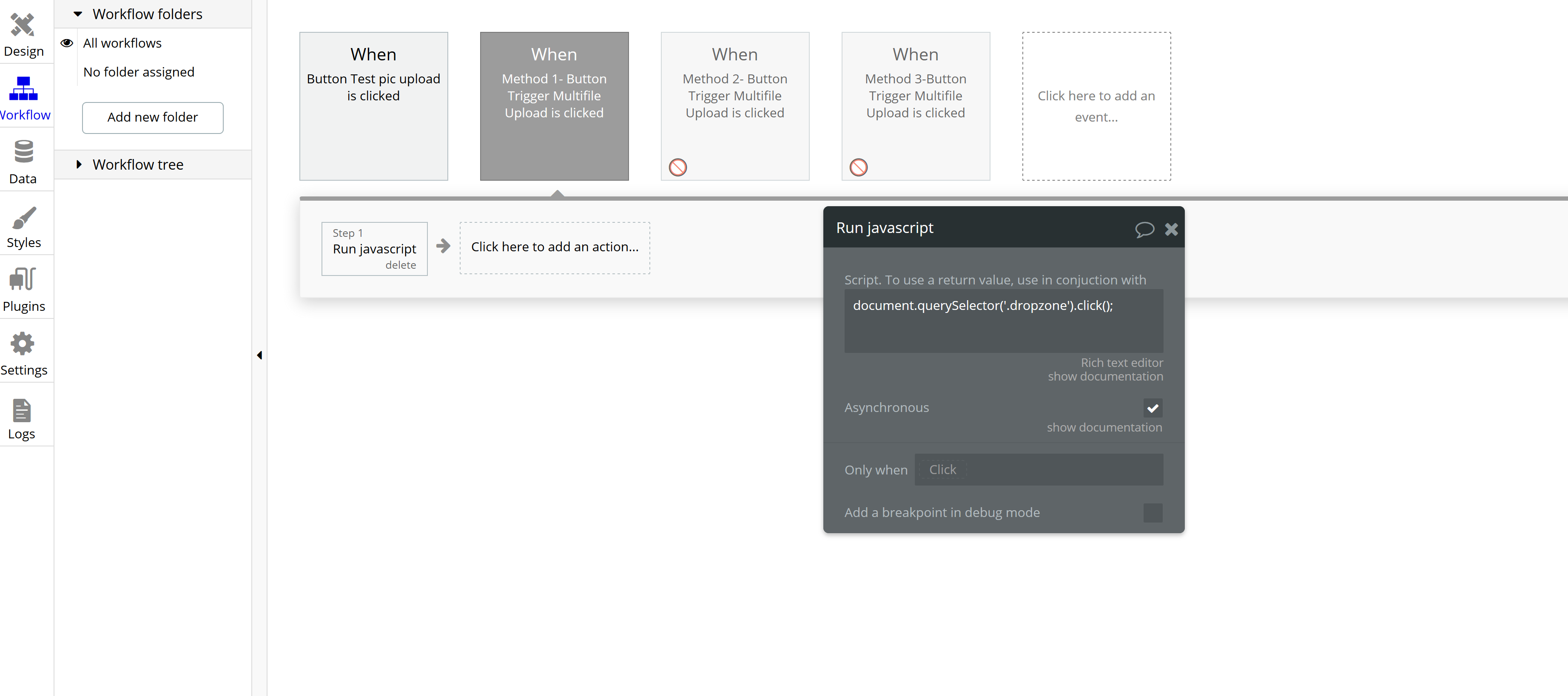

Go to the workflow tab and under the button workflow, use the action run javascript from the toolbox plugin.
  1. Again, this is for when you only care to trigger the first mfu on the page. The code is
    document.querySelector('.insertcssclass').click();
or specifically
document.querySelector('.dropzone').click();
  1. Again, this is for when you have multiple mfus on the page and you want to select a specific one based on the order on the page the mfu appears. If you’re trying to trigger the first mfu, use
document.getElementsByClassName('dropzone')[0].click();
Don’t put a period in the class name, the code won’t work. The “[0]” is how you’d select the mfu. Since javascript uses zero based numbering, [0], would be the first mfu, and [1] would be the second and so on and so forth. Again, the mfus would be ordered from top to bottom, and left to right. Feel free to test it with two mfus and put the 2nd mfu at least below and/or to the right of the first mfu, then change the number to “[1]” in the code.

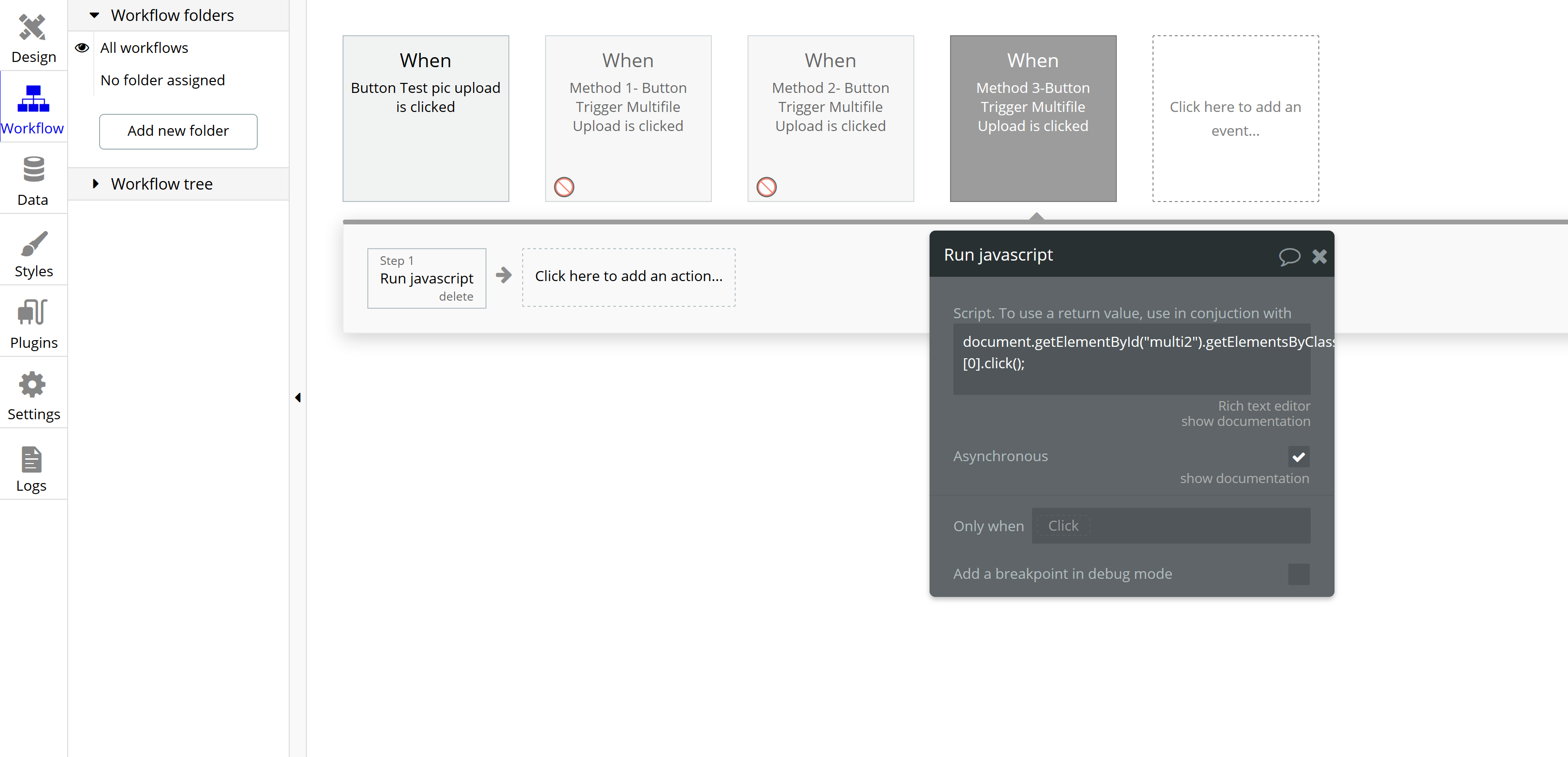

  1. This is ideal for having multiple mfus on the page and want to pick a specific one without considering the order on the page the mfu appears.
Use
document.getElementById("multi2").getElementsByClassName('dropzone')[0].click();
if your ID Attribute was “multi2”. This code just simply means, click element [0] or the first element that has the ID attribute of “multi2” and has the classname of “dropzone”. If you’re properly creating unique ID attributes for each element, this works. I’ll guess that even if the ids are not unique, it could work, but you’d probably have to change the “[0]” to the number you’re looking for. As a general rule, each id attribute you name should be unique.
