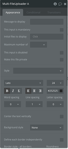

First install the bubble plugin for multifile uploads
After that place the element on the page. You can edit the design a bit. I made it “invisible” so that I could have a custom design for user experience

I accomplished by placing a group “on top” of the multifile upload element…however you must “bring to front” the multifile upload element so that it still functions.

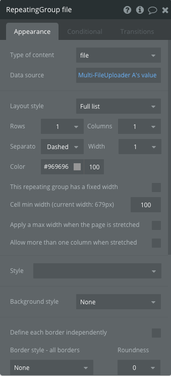

Then you need to have a repeating group on the page. This is set to the value of the multifile upload element

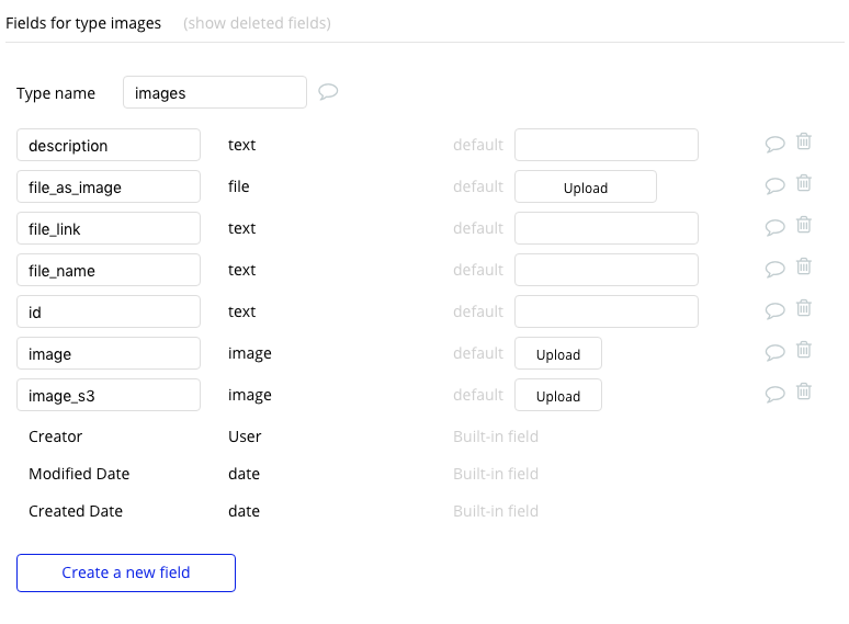

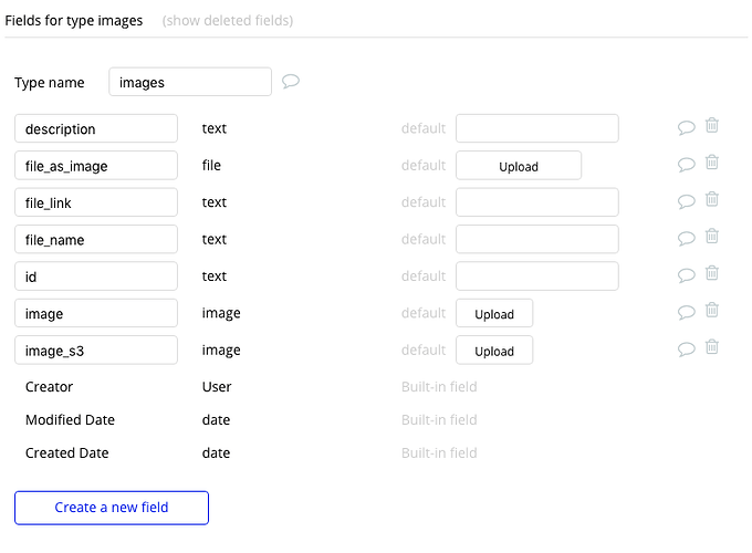

Style your repeating group content anyway you want. However, it is important to have your database set up properly to save the images.
Notice that I have image_s3 with a type of “image”…this is the important component to save the file as an image to be able to use all functions for images such as processing with imgix

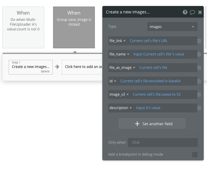

Now what you need to do for this to work is to put a icon or button into your repeating group to enable saving individual images…I have not yet created a “save all” button but assume it won’t be an issue. I am still working on all of the design aspects but have a workflow set to save the images.
It is important to remember that the “images” in the repeating group is only set to the value of the multifile upload element on page, so they are not saved to your database until this workflow event on the click of a button or icon in the repeating group cell.
It is at this point that you can save the URL to reference as an image, but to be able to use all image functions like process with imgix, you must save as a “current cell’s file:saved to S3”
Then when you want to reference the dynamic data in image elements you reference the “image_S3” and you’ll have a regular image from you database.

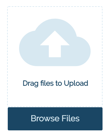

I am having one issue with the design though.
04%20AM
I don’t know how to change the look of the multifile upload element during the upload process…I’d love to have full control of the background color and content or just be able to hide it altogether.
If anybody has any idea of how to change the style with CSS or JS or how to hide it, I’d really appreciate the help on the topic.
See my reply in the original post on the hack to hide the element.
You can also hide it completely and use a bit of JavaScript to trigger it.
  1. Install the “Toolbox” plugin, find the “Run JavaScript” Action
  2. Make sure you can set HTML ID on your elements (found in settings)
  3. Set your uploader element ID to “uploader”
  4. When the element is clicked, trigger the “Run JavasSript” action, and run this code:
$(’#uploader’).find(’.dropzone’).click();
