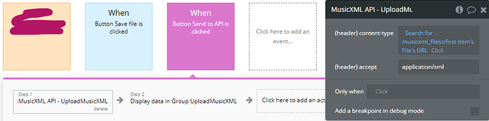

Here is my workflow configuration.
Unfortunately, Bubble returns always the same result, which is the one of the file provided in the API.

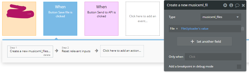

First, let me show you the front end.
I select the file with the File Uploader, then I click Save file to store the file in the database, and then I click on Send to API.
In the final version, I will have only 1 button to store and send the file to the API.
Now, the workflow settings.

I don’t see any place where you send the file with you upload action. The Content-type header shouldn’t be modified (same for accept header). You can keep both private.
Where is your “file” field? Make sure it’s not set as “private”. You can also clear value in API connector
Are you sure you are using the corect Call?
You should have something like @Zeroic show in is screenshot for the file.
