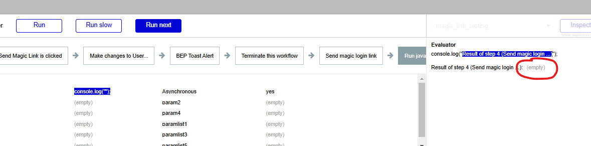

I am trying to use the magic login link action. It works fine when I don’t have this checked (email arrives as expected in my inbox):
But when I do have it checked (which is what I need to have it set as), I just get an empty response
I am doing nothing special. Here is my full setup in the action (pretty much everything is default values):
a
I have also confirmed that the email is populating correctly:
Anyone having any similar issues or can see something dumb that I’m doing wrong?
I think you can’t see the link in debug mode, but it should still work correctly. Try sending out an email with the result of step 4.
Wow. You are right. Don’t know why I didn’t think to check that. Thanks so much. I was getting thrown by the fact that it wasn’t showing up in the console.
