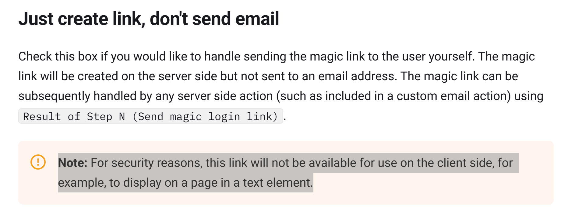

I just read this in the docs. Could be the issue your facing? Account | Bubble Docs
Jonathan is correct. The expectation with Magic links is that you email them to the user they were created for. From a security standpoint, it means you cannot “view” the link.
Attempting to use it in a custom state or as a readable text is a security risk.

Bubble is indeed not allowing me to access the magic link, even though the option to “only create the link and not send the email” is available and checked.

I appreciate your help in clarifying that I wouldn’t be able to access the link.
