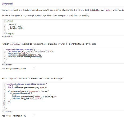

Hi, in a custom plugin i’m sending event like this, it can send multiple events in less than a second.
instance.publishState(“task_changed”, mytask);
instance.publishState(“startdate_changed”, start);
instance.publishState(“finishdate_changed”, end);
instance.triggerEvent(“on_date_change”)

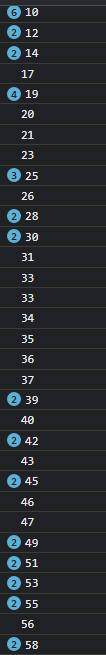

On the app side I’m using “my componnent date changed” , im well receiving multiple events but the state is not working as expected. Because the workflow do (make a change to a thing), i’m getting only 50% of the exposed states. Is there a way to triggerEvent with parameters instead of using exposed states ? Or a way to ensure events are treated in sequences ?
I can throttle event sending in js but it seems hacky :frowning:
Thanks !

I say the events are sent too quickly and the processing time of the event does not allow me to capture all the states. If in the “my componnent date changed” I put only Console.writeline(), I’m capturing all the exposed states. I’m sorry not easy to explain.

I created a plugin to isolate the issue
I can workaround, but it should work, it works with vanilla js, if we could send parameters with triggerEvent(), i think it could resolve this.
