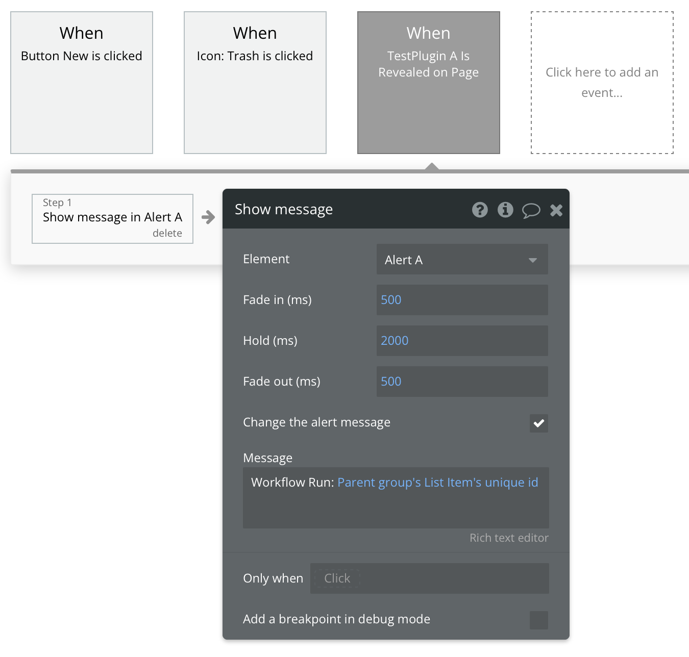

I was hoping you could elaborate a little more on your solution. I have a very simple plugin that triggers an event when the plugin is initialized on the page.
Every time I create a new thing and it is added to the repeating group, it should trigger an event. When the event is triggered, an alert should appear showing the unique ID of the parent.
This works most of the time, until I delete an item from the repeating group. However many items I delete from the repeating group, the event will not trigger for that number of times. So, if I delete one item, then the event won’t trigger the next time a thing is created. If I delete two items, then the event won’t trigger the next two times a thing is created.
Is your solution a potential workaround for this issue?

As you’ve probably figured out, when a RG is downsized, those elements that were there, stay there. So the instances of your plugin never get deleted and initialize doesn’t run until a genuinely new row is added.
The way that I get around this is having a controlling state on the RG for each action you want to perform - e.g. index_to_add in your case - which is a number. When the add button in the cell is clicked then this state is changed to the current cell’s index / new cell’s index - whatever applies.
Meanwhile in your plugin you add two fields: current_index and index_added. Every time either one of these values changes your plugins update function is going to run - so all you need to do is a) check whether that plugin instance’s current_index === index_added:
function(instance, properties, context) {
if (!current_index || !index_added) return; //if either are empty then don't bother
if (current_index === index_added) {
instance.publishState('what_cell_is_added', `properties.current_index`);
instance.triggerEvent('revealed', function(err){});
Finally, in your Revealed event fired workflow you want to reset your index_added state back to null, as well as show your Alert etc.
