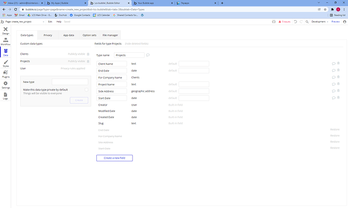

I have two data type (i will have more later)
All Clients
All Projects
Every client will have multiple projects and i need to link the to database. I’ve created a type field under projects called For Company Name that is from data type clients.
I can retrieve the information on my front end through a search box but when i continue to create a project and hit continue the the search result does not record in the For Company Name field
I can however add the For Company Name through the little pencil on the database but not through the front end.

This expression is a type mismatch (it’s currently evaluating to a yes/no when it should be a Client) - hence why it’s red.
Your ‘For Company Name Field’ is a ‘Client’ type, so the value here needs to be a Client.
So, assuming your SearchBox is set to display ‘Clients’ then you just need to add its value here
