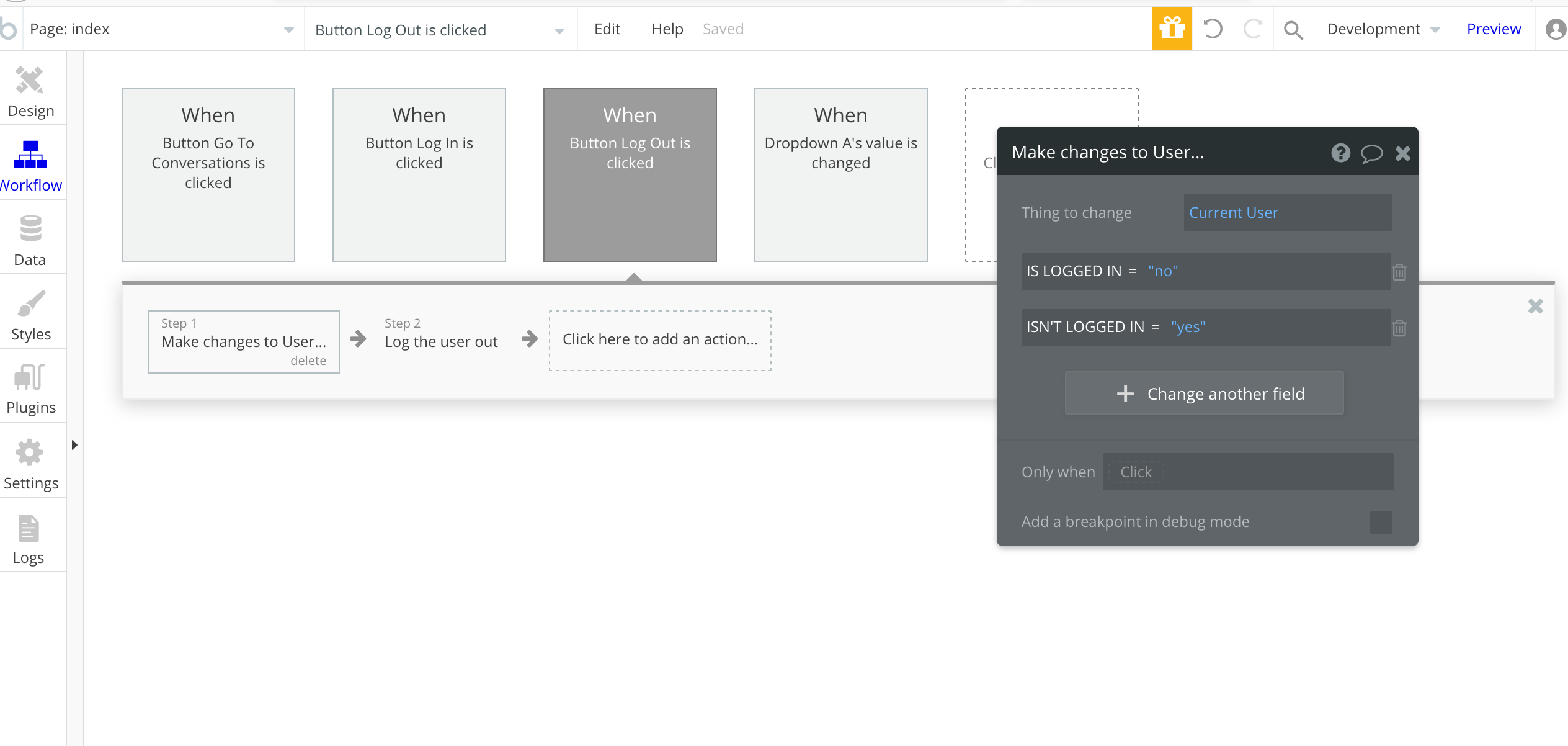

So I don’t actually have a workflow that is able to change that to the appropriate settings on a user log out. The workflow I used for user logout is below.

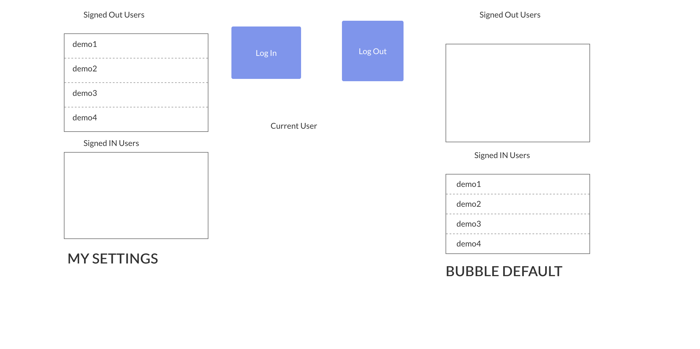

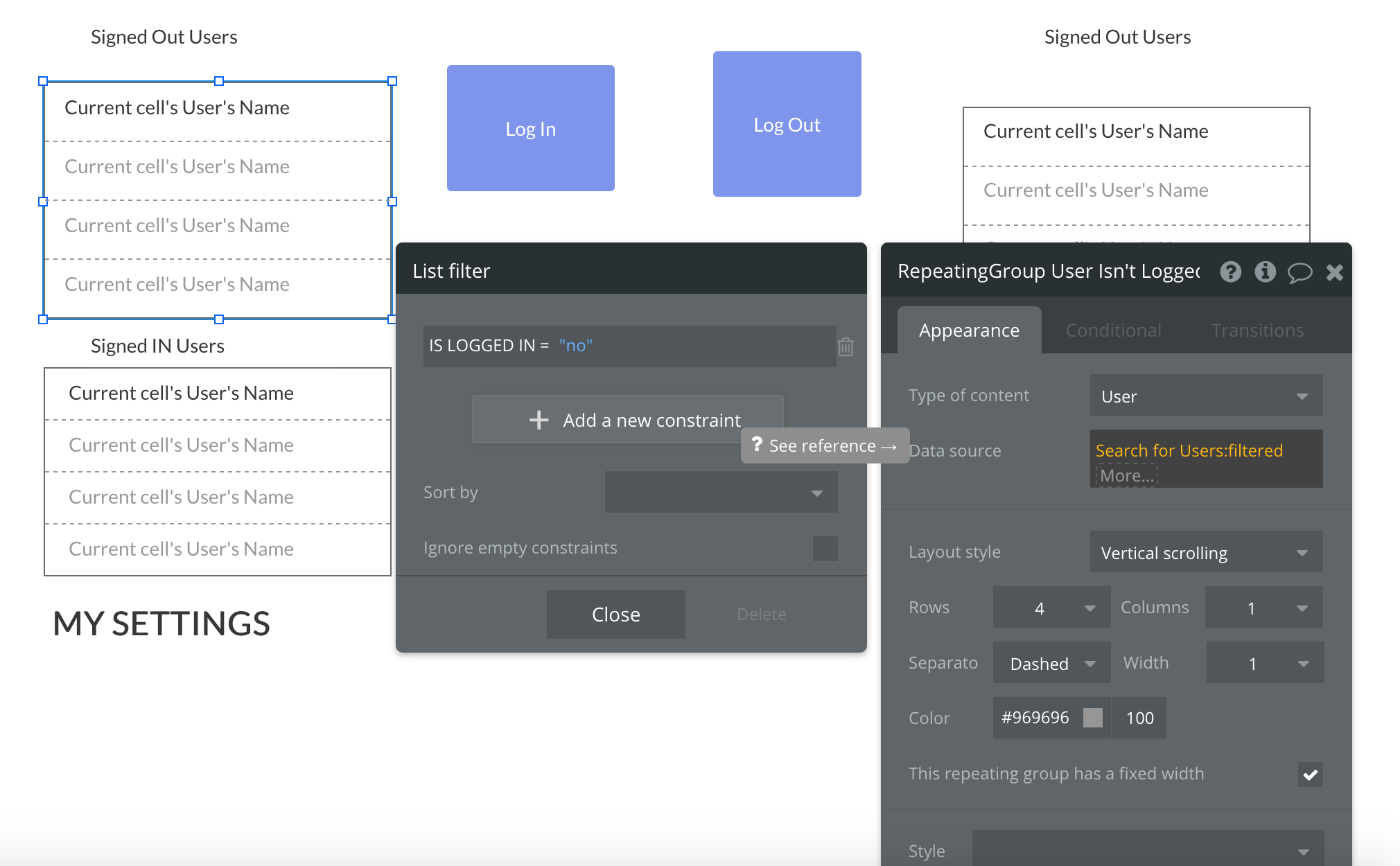

This is my setup for filtering users. One shows it using my settings and the other the bubble default settings. (The Data Should be the same)
This is how it looks on display

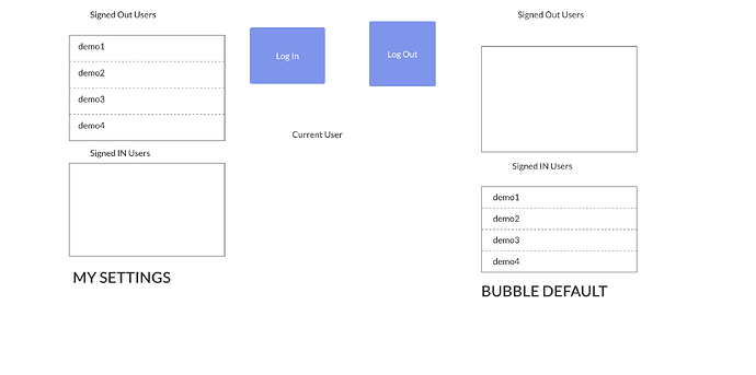

Below shows when I have logged all users out.

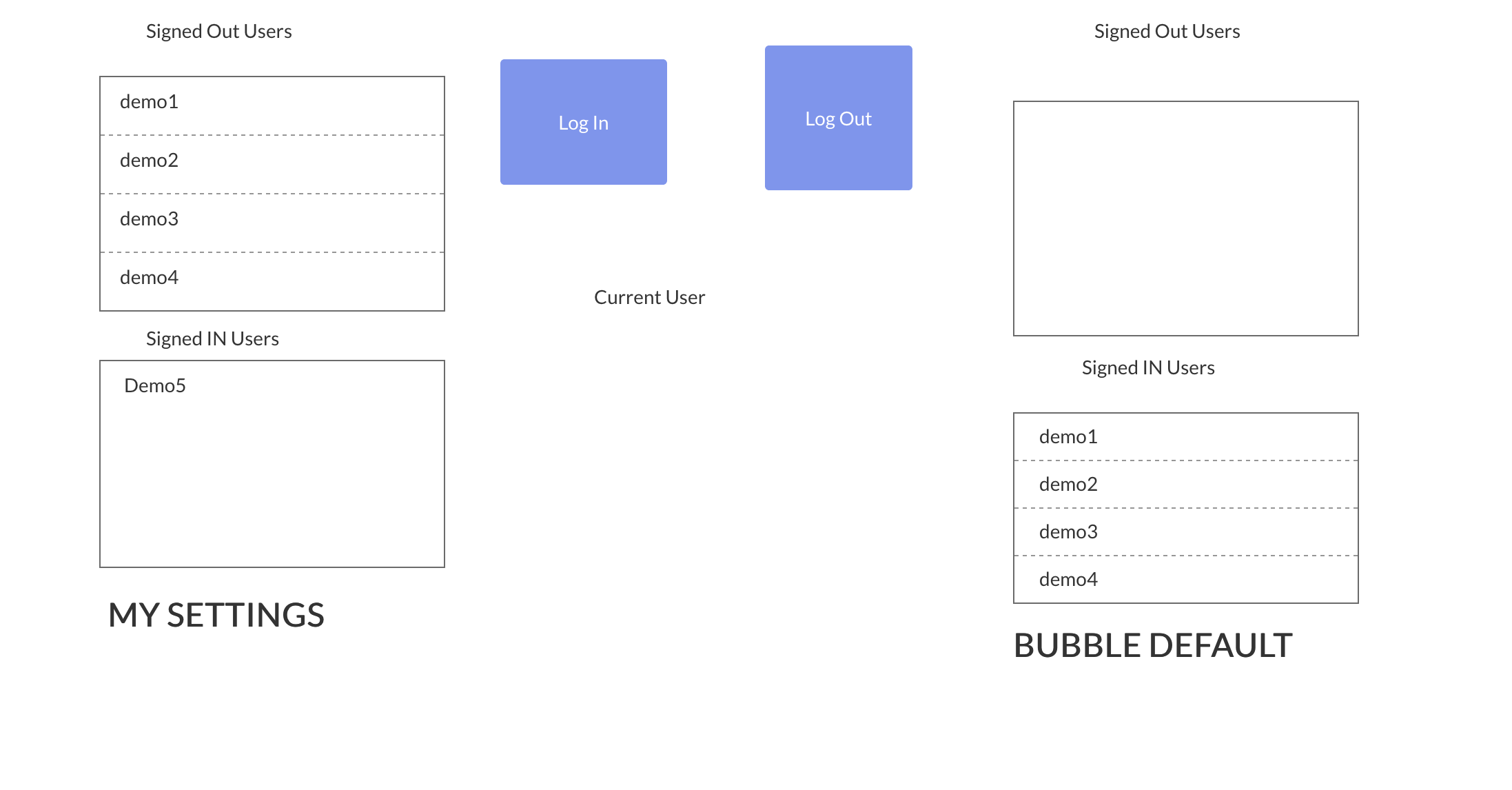

This is what it looks like after I sign in two different users
And then after I log out one of them
This is my workflow

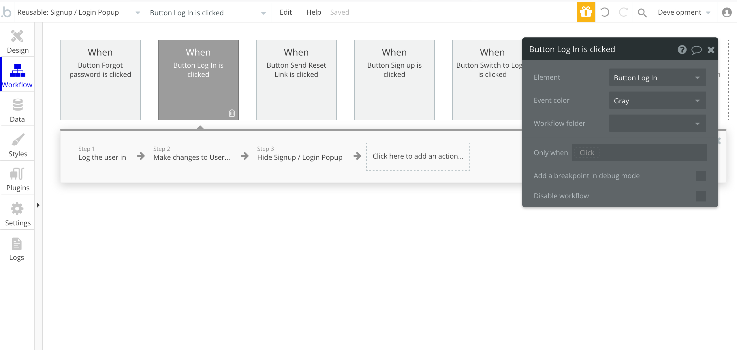

And lastly the bubble default log in reusable element workflow
