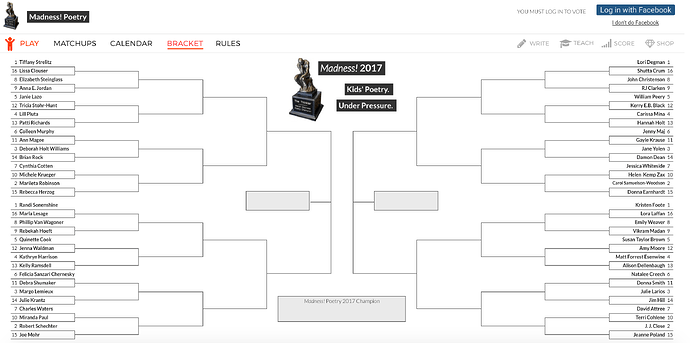

Not necessariliy, but I’m about to have a bunch of users hit it and want to make sure it’s optimized. I’ve got an NCAA-style tournament starting in a week, and the “bracket” page has a bunch of “searches” to pull certain information for each matchup. But again, each search is hyper-specific to that particular matchup.
I feel like I should be just doing ONE search (really just a table reference), and then within that just pointing to an indexed record of data to grab what I need. Seems really inefficient to have 63 individual searches (one for each matchup) on the page. But maybe the way Bubble executes each “search” is just as efficient.

Scott, can you elaborate further? I feel the data are stored optimally. I’m just not sure how to best refer to each Thing from my table in the Bubble UI. I could easily grab all the records and associated data in a single query (and elsewhere in the app, I do). I just don’t know of any other way to say put Item A’s whatever in slot 1, Item B’s whatever in slot 2, Item C’s whatever into slot 3, such that I can effectively display select data from the table like this:
It may be that it’s already pretty efficient for Bubble to handle it as is with all of these “searches”. But it just feels wrong. All I’m really doing is displaying one table’s data in a novel layout. No joins, no transformations, no anything really.

It’s pre-specified. So certain Things have to go in certain spots. But a bit more abstractly, there are four “regions” A, B, C, and D; there are six “rounds” 1, 2, 3, 4, 5, and 6, and within each bracket in each round there are n matchups (respectively 8, 4, 2, and then 1). So each matchup is basically “keyed” as 1A1, 1A2, 1A3, … 1D8 … all the way through 4D1 (round 4, bracket d, matchup 1).
So I could sort a general Table search on that key field, and in theory the matchups would be listed in a known order, and I could just point each display element to the right result number using that “:nth item” function.
Maybe that’s what I’ve been looking for … but other thoughts welcome, please.

Updating this old thread. Thanks to those who offered advice previously. I’ve been going back and optimizing areas of my site that were not performing very well during my March event. Here’s how I optimized this page and the result:
  • Instead of 64 unique (but nearly identical) searches (one for each “bracket segment” that I need to display), I created a new unified search that force-ranked the displayable items based on a certain database field that I can guarantee will maintain order (a systematic “key” if you will).
  • I replicated that same search in each segment, and simply appended :item # after, plus the unique number of each item I need to display in the order I need to display it.
That’s it. The result:
BEFORE: According to Chrome dev tools, this page included three separate searches (one returning 31 results, another returning 31 results, and a final one returning 2 results). Combined they had to wait 11-14 seconds for Bubble to respond.
AFTER: Now it all happens in one search that consistently waits less than 1 second for Bubble to respond. So now the time to render the full page content (essentially just the bracket) is far faster. Huge difference!
