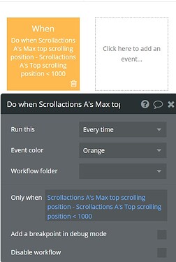

Install this plugin to get the scroll position of the RG: Scroll Actions (Scroll Position) Plugin | Bubble, follow those instructions like putting the element on screen and settings the RG id, etc.

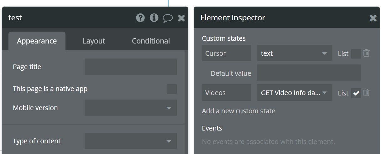

Set up a custom state for the current Cursor position, and a list field to store the entire list of videos.

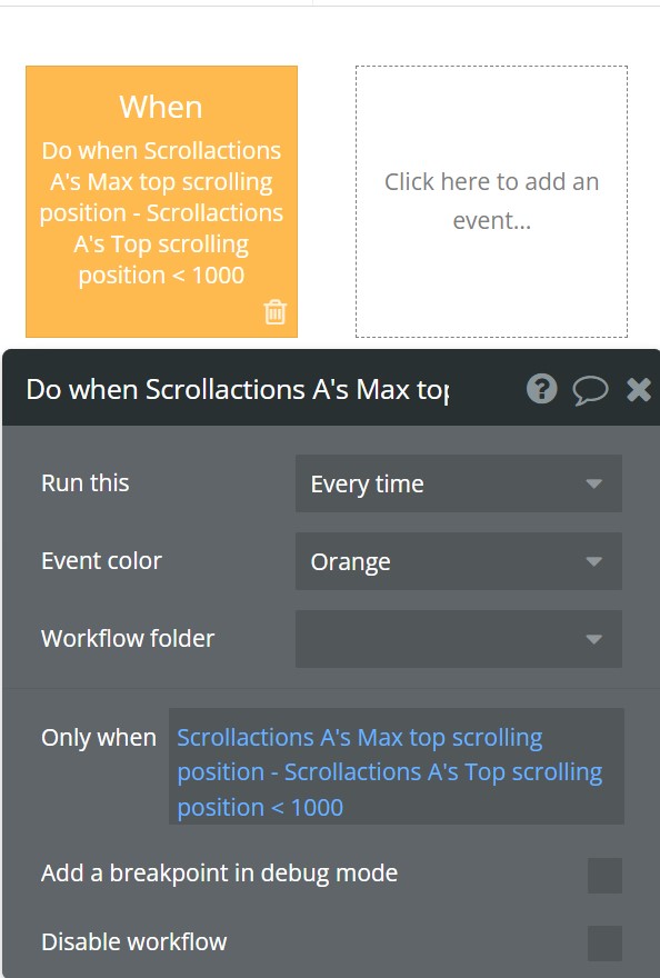

Have a “When condition is true” event trigger based off of the scroll position being below the threshold you want (The max pixels minus the current pixels)

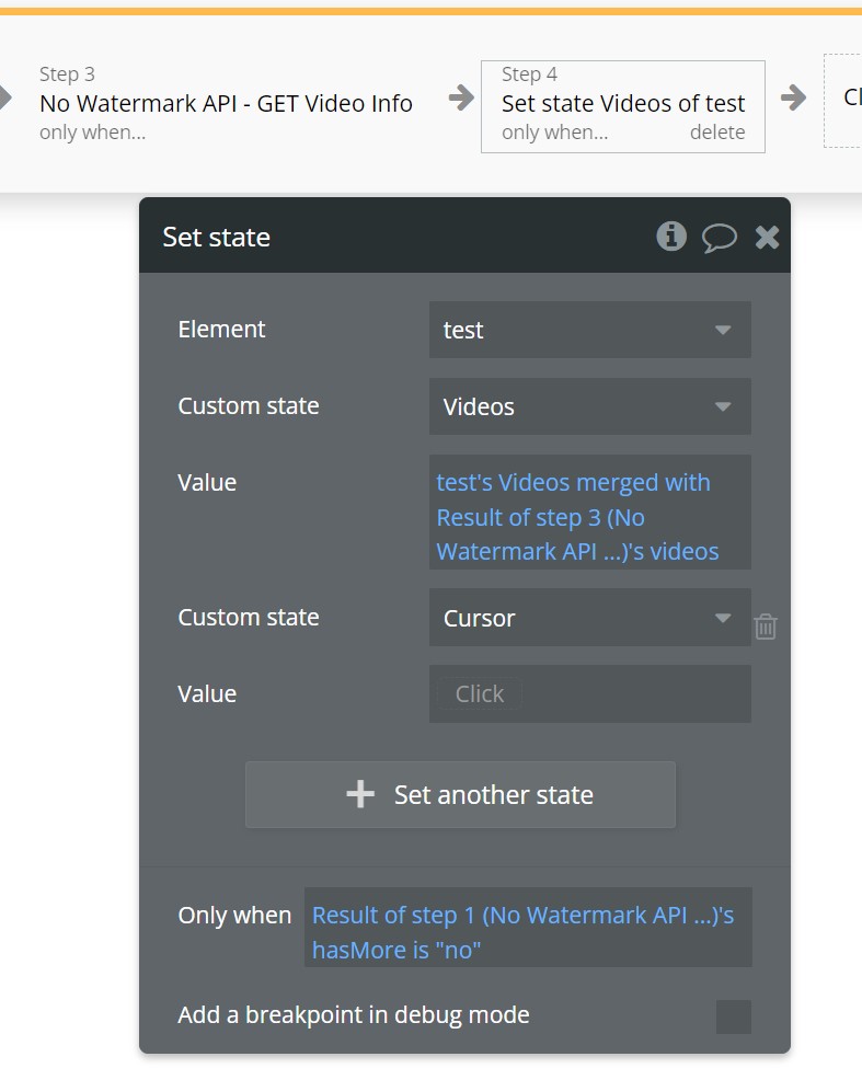

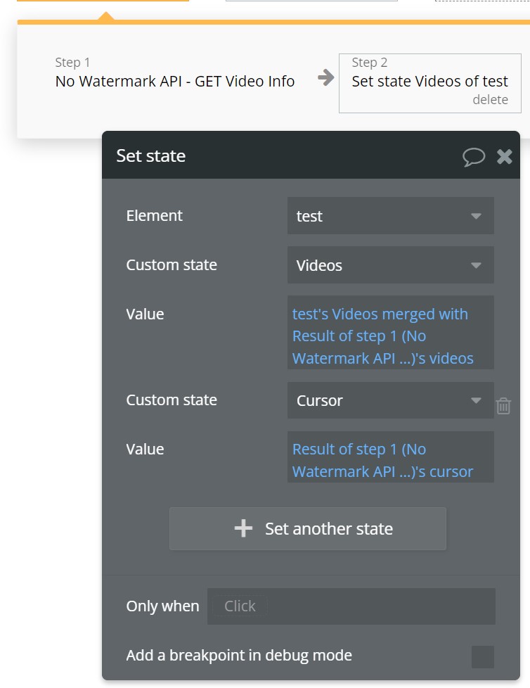

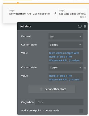

In @jed 's case the API returns the current cursor position so you can make a call later and “continue the search” from where the last one was. So save the cursor in the custom state, and merge the current list of videos with the new list.
Then the RG just needs the point to the Videos list custom state (check the box to display all results immediately since they are coming in chunks anyways)

In this case the API returns a yes/no if there are more results or not, and if the cursor is empty it will start over the search again, so there are some addition steps to do another API call with empty cursor
