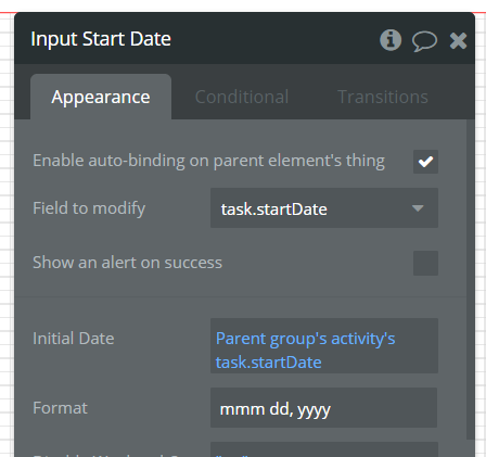

@levon, it’s now showing the values from existing fields, but it is not saving changes using auto-bind.
This is what my settings look like.
Keith, it works when we try it on our end, to debug it in your app, we’d need access to plugins@zeroqode.com
Levon, I tried direct messaging you, but it seems that’s not working.
I’m happy to walk someone through the issue on a screenshare. I prefer not to provide access to my app.
