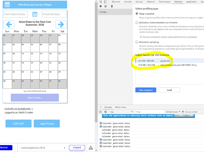

Look at this snip of the page in question:
This not-incredibly-complex page (of type Listing) is ballooning at times to more than 300 MB used, if the user is logged in and the user is this Listing’s creator. When that happens, this calendar widget becomes extremely sluggish and (for example) navigating to the next/previous month by clicking the arrows takes a long time.
In comparison, a more data-intensive page (also of type Listing), which is displaying photos, a bunch of textual information, etc, etc. stays around 100 Mb (still big but not half a GIG as in the above screenshot).
Crazy-making, no?
This MIGHT be moment-timezone’s timezone info, but it’s weird that this giant memory inflation doesn’t happen for EVERY version of this page… just some Listing’s… can’t explain it.

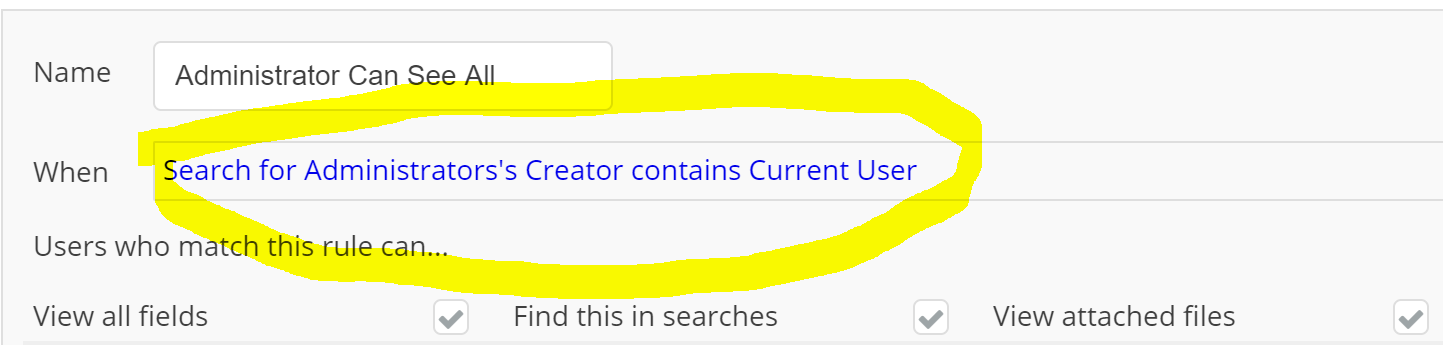

I GUESS the workaround is PRIVACY RULES at the page level? But what a hassle… and can those even be defined that way? (I think they probably can be, but the Expression field on the Privacy tab seems pretty buggy – it often doesn’t allow the building of complex expressions. I find one often has to build the expression in some other element and then copy and paste it to the “When” field. See below:
(^^^ you can’t build this expression in this field – but you can build it somewhere else and paste it here… bug or feature??)

Today I’m definitely going to futz around with whether it’s possible to use page-specific data privacy rules to better control the loading of irrelevant data on this and similar pages.
A quick update on this (@mishav) : I had mused that it might be possible to control data loading by using Privacy rules that incorporate something like “and Current Page doesn’t contain ‘some string’” or similar.
In general this approach does not work as Privacy rules are implicitly "OR"ed and unlike Conditions on a Conditional tab, do not have an order of precedence. (Per the reference, “When multiple rules apply, the user has access to an object if any one rule grants access to it.”)
So while you could do this, the conditions become inordinately complex and I don’t think this is a smart approach at the current time (it is very hard to maintain).

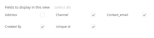

Isn’t this more or less implemented in the DB views?
I haven’t done tests on this to check if unchecked fields are retrieved or not.
