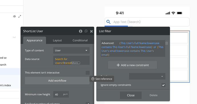

I’ve run into the same issue before — here’s a workaround that’s worked really well for me:
You can use a regular input element for the search, then filter your list using :filtered → Advanced.
Inside the Advanced filter, set up a condition like:
This item's [field]:lowercase contains Input Search's value:lowercase
Make sure to check “Ignore empty constraints” so your list doesn’t break when the input is empty.
This approach works smoothly and makes the search case-insensitive, so you’ll get consistent results without needing a “search” button or special workflow triggers.
You can also check the screenshot I’ve provided to see how I set it up.
