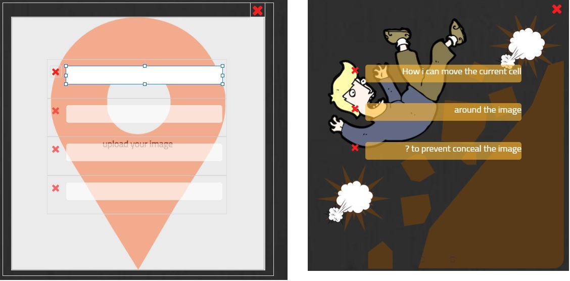

I am working on website and i reach to difficult feature where i need to move the text in the repeating group around the image !! How i can move the current cell in the repeating group in the image ? and if that possible how i can save the current position for the movable text in the database ? any plugin or helpful thoughts really appreciated

Thanks a lot for your reply and trying to help , actually you are right making things simple is always more clever , but in my case moving the text (Not resize it ) is a game changer to my app and provide main feature to the art work in the app. I have found these 2 resources that may help me but :

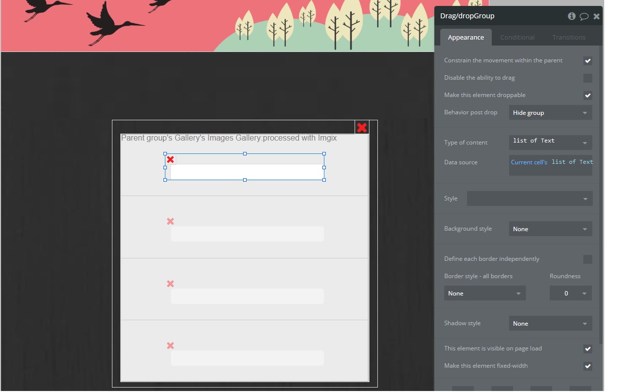

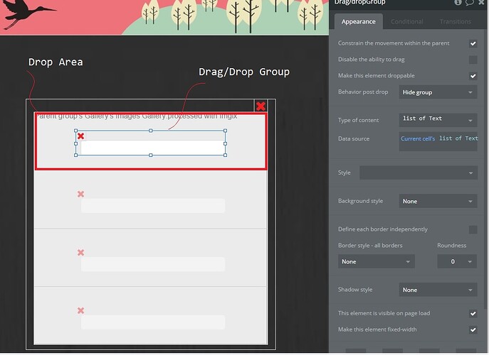

Hi , Thanks again … if i understood what you explained , I think yes you are right , it seems moving text that exist in the current cell in the repeating group then drop it on a random position on the image ( outside the current cell ) not possible ! but what if i move the "drag/drop Group " and drop it in the"Drop Area " that exist in the same current cell in the repeating group [ Kindly check the screen shot ] ? I have tried this option but it didn’t work either !
  • Yes i can move the whole repeating group "on the image ,i can consider this as a secondary solution for my case , however i really appreciate if you can explain why i can’t or if it is possible to move group"drag /drop"and drop it inside the "Drop Area " in the same current cell of a repeating group !

Make sure that the drag drop group is NOT a child of the drop area and everything should work within the cell, I think. If it doesn’t and you’d like some help troubleshooting, share a sandbox with me and I’ll take a look :slight_smile:
